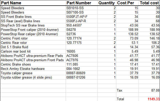

I did the whole upgrade to 5th gen calipers and rotors. Along with the job I did the Brake lines at each corner and the rear intermediate, added speed bleeders to the calipers, replaced all fluid with dot 5.1, replaced rear shoes, replaced all e-brake hardware, used Toyota caliper grease (anti squeak used on back of pads and metal to metal places, and Toyota rubber grease for slide pins.
Below is the breakdown of cost and part numbers I used. When I do the brakes on a new-to-me vehicle, I do it all so I know where it stands.

Am I missing something....your photo shows 4 calipers but the list/price list only has 2 calipers, 1 front and 1 rear?
