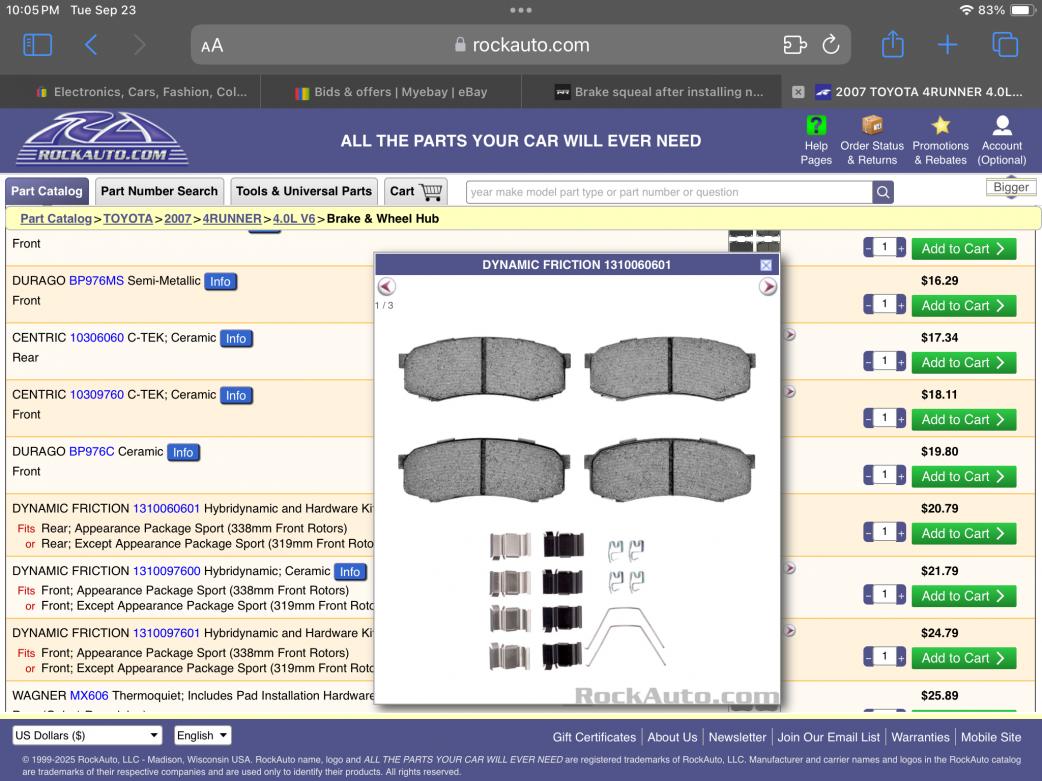

Its been a minute since I did my brakes. Did the rear pads come with springs?
Yes came with springs. The strange thing is that they only squeak when first leaving the house in the morning. After a couple of stops, they stop squealing. However, they are quite loud when they do squeal...
