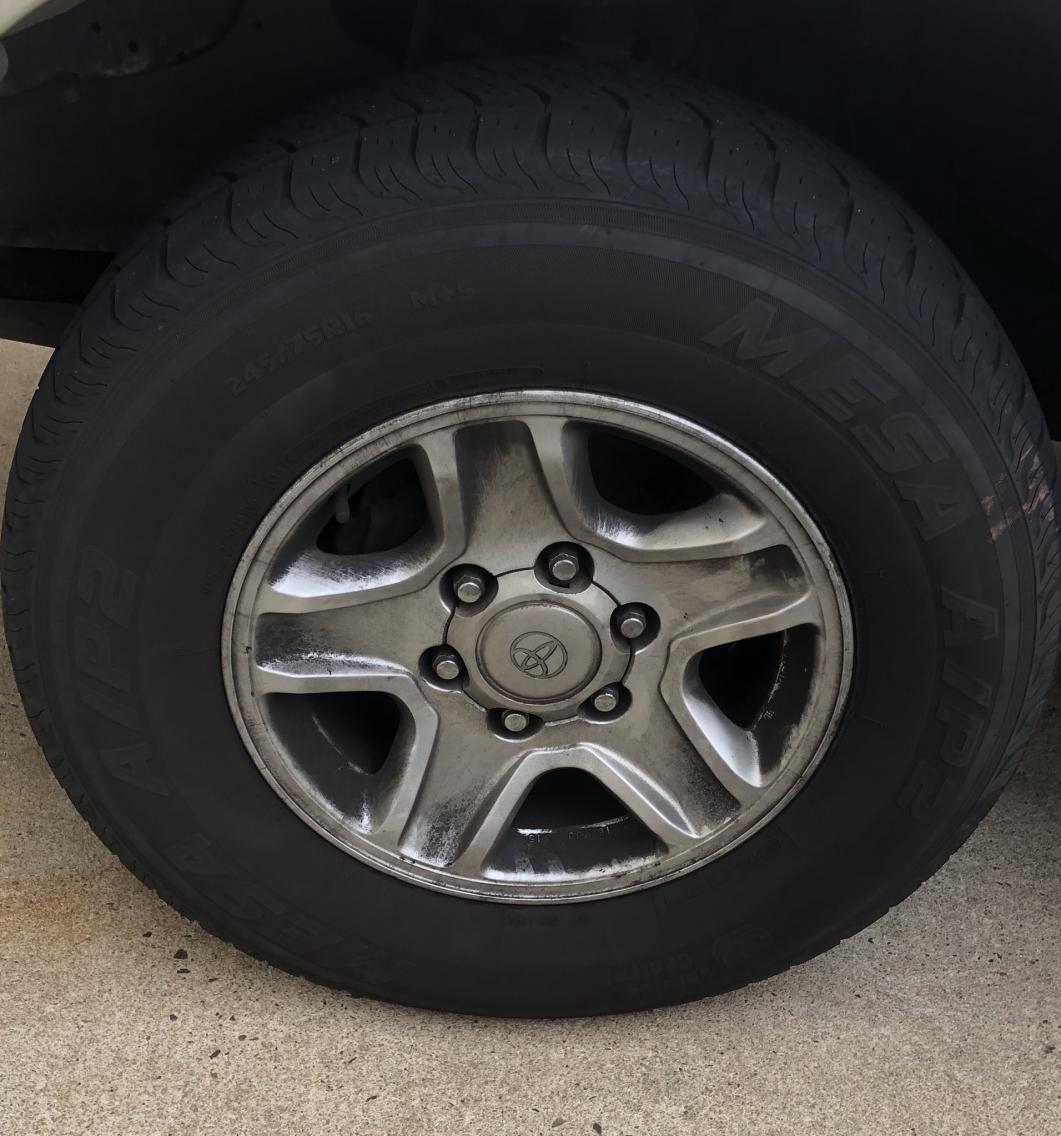

I want to upgrade to the tundra 231mm brakes. Can someone tell me if my stock wheels will work with it . Thx in advance

Search up the brake upgrade post...there's a few that I read to do mine last month...I had the 5 stars that you have on it now but got new 18s so I'm not sure if they'd fit or not...pretty sure the 199s will fit.

Yup same wheels as me. I just purchased all new napa parts and did the swap. I love it. Solid upgrade for $400ish for everything?
Just have to cut the thin metal brake dust shroud. I just used some tin snips if I remember right. whole job only takes an hour or so, super quick if your used to changing pads and rotors.

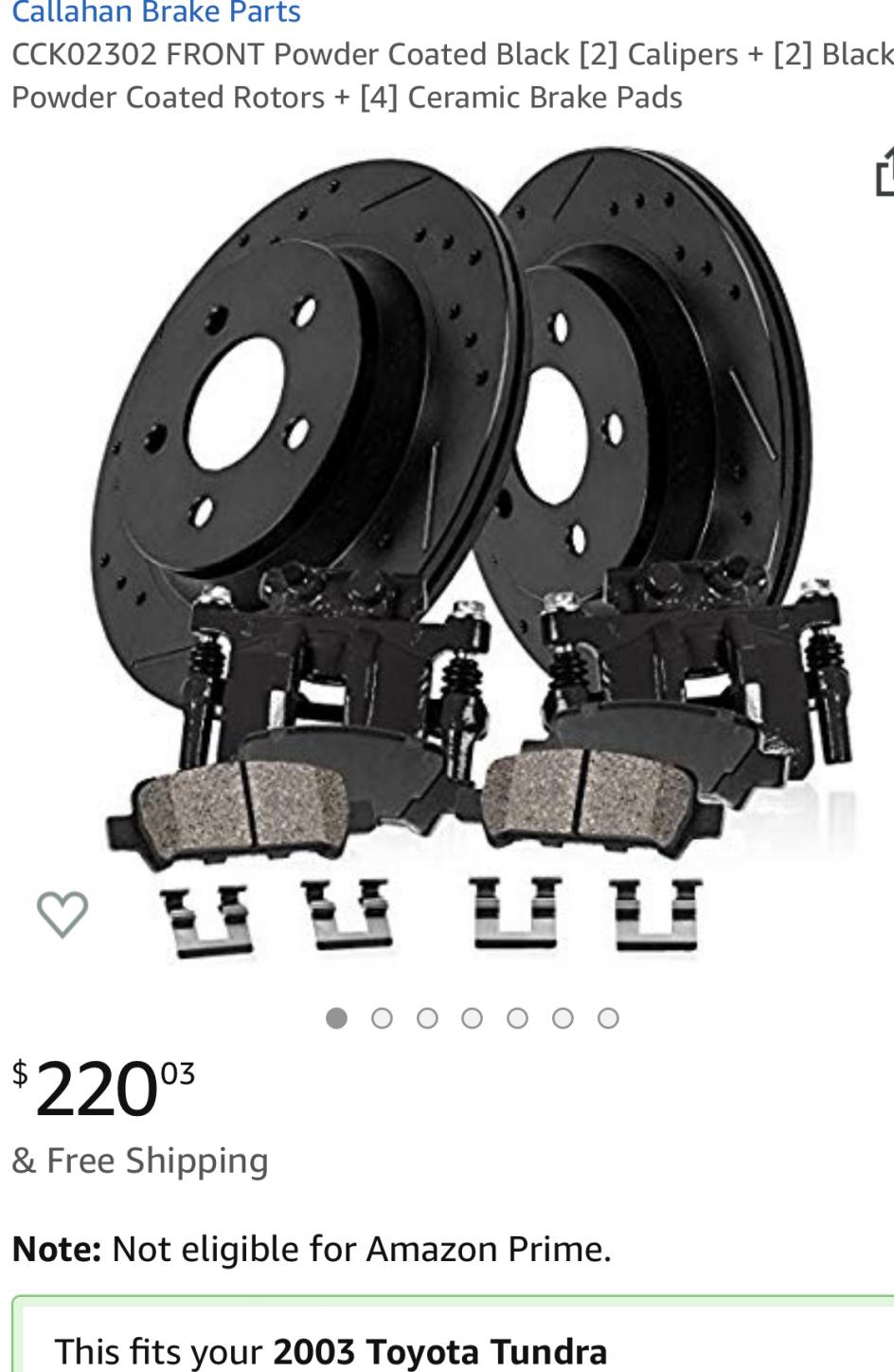

Amazon got this kit.

Seems super cheap to me right from china direct. Id be worried it has issues and would be expensive to return. Keep us updated.

Might need to trim a little but they should clear.

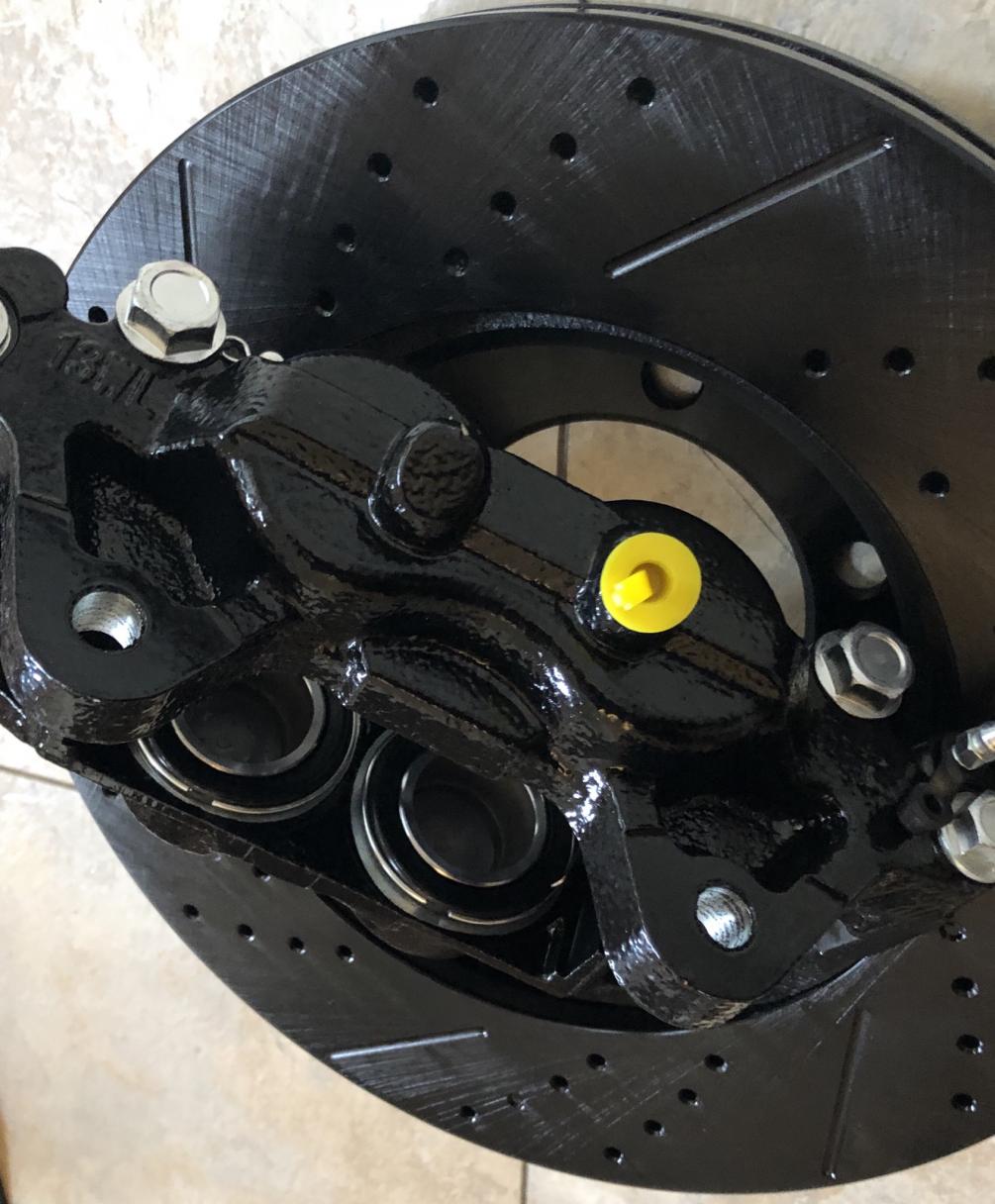

No need to trim the wheels, but for the 13WL, you will need to trim off parts of the brake dust shields to make the calipers fit. Timmy the Toolman has a very informative video on this. As always, I followed his video and did mine. It was completed with no issues.
Cracks me up how the pic is not correct for the calipers...hate when they do that!! Have fun with them!!
Thank you I did read some pages but no luck. How do you like the upgrade. It’s it worth it? I can get the whole kit at amazon for 160.00 everything included.
thats a pretty good price, i bought all of it at advanced auto using coupons and it came out to like 300 for both calipers, rotors, and pads

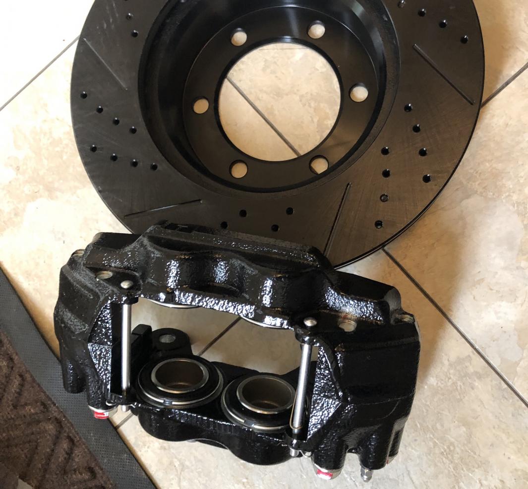

I received my big brakes today. They look sexy
