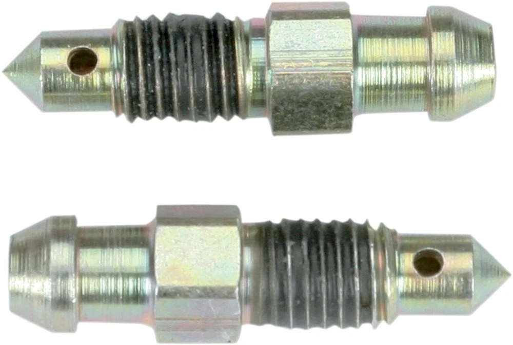

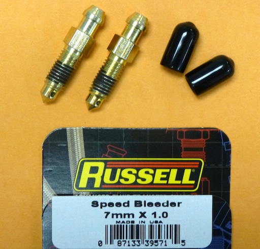

Broke my front brake bleeder screw with the TBU. You need a M7 x 1.00 brake bleeder screw for the Tundra brakes. I upgraded to a speed bleeder screw.
Fixed it using a HF Hercules screw extractor.
https://youtu.be/XUyTg7X5RBM
Goodridge: SB7100L, SB7100
Russell: 639570
