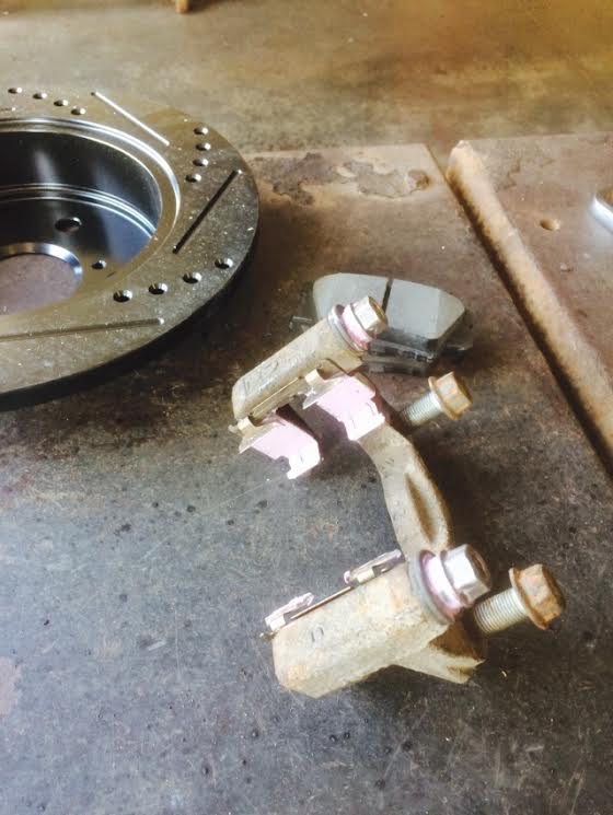

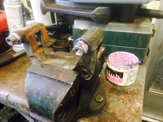

From RAV4 Forum:
I bought the premium brake kit (G3500 cast iron rotors & ceramic pads) last year / rears installed.
- this product ships out of the GTA-Toronto area / so Canadians save large / currently 50% off
- rotors are drilled, slotted & coated / I broke the brakes in hard, for 15 minutes
- my garage friend charged me $150 labor, to do the rear axle / include lube calipers, pins & shims
- still using original calipers, that came on the 2008 RAV4 v6 / one was sticking, mechanic fixed it
^^ Probably saved $700-800 per axle avoiding Dealership, and end up with great parts.
- could not be happier / improved stopping distance & zero noise
- brake dust on alloy rims, almost nothing
- will have the front brakes done, this fall
- since I ordered a 4 wheel kit, just a labor charge next time

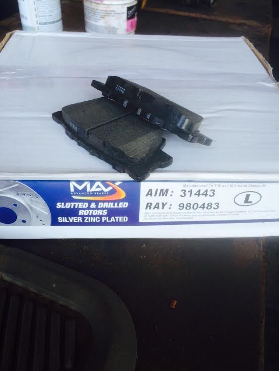

MaxBrakes ELITE xDS Series Kits, shipped out of Ontario, Canada:
Brake Kits - ELITE xDS Series Kits
^^ Company also ships to USA customers.
First time I bought a 4 wheel brake kit, saved $500 in parts (for Jimmy), not purchasing from local NAPA/UAP.
Wow. This whole set up is only $150.. ELITE xDS Series Combo Brake Kit
Quality (thickness, coating, etc) looks amazing plus they are drilled/slotted.
If I had seen this deal I would have ordered it.
They are the best quality for the $$ & currently 50% off sale / the MaxBrakes rotors, are a nice precision product.
- the RAV4 brake job got treated to ceramic brake lub (caliper pin maintenance)
- the rotor castings are thick and the G-3500 grade of cast iron says shinny / no rusting away, like the cheap "white box" brands
- the ceramic brake pads, don't come with the shims / go to reuse the original ones
