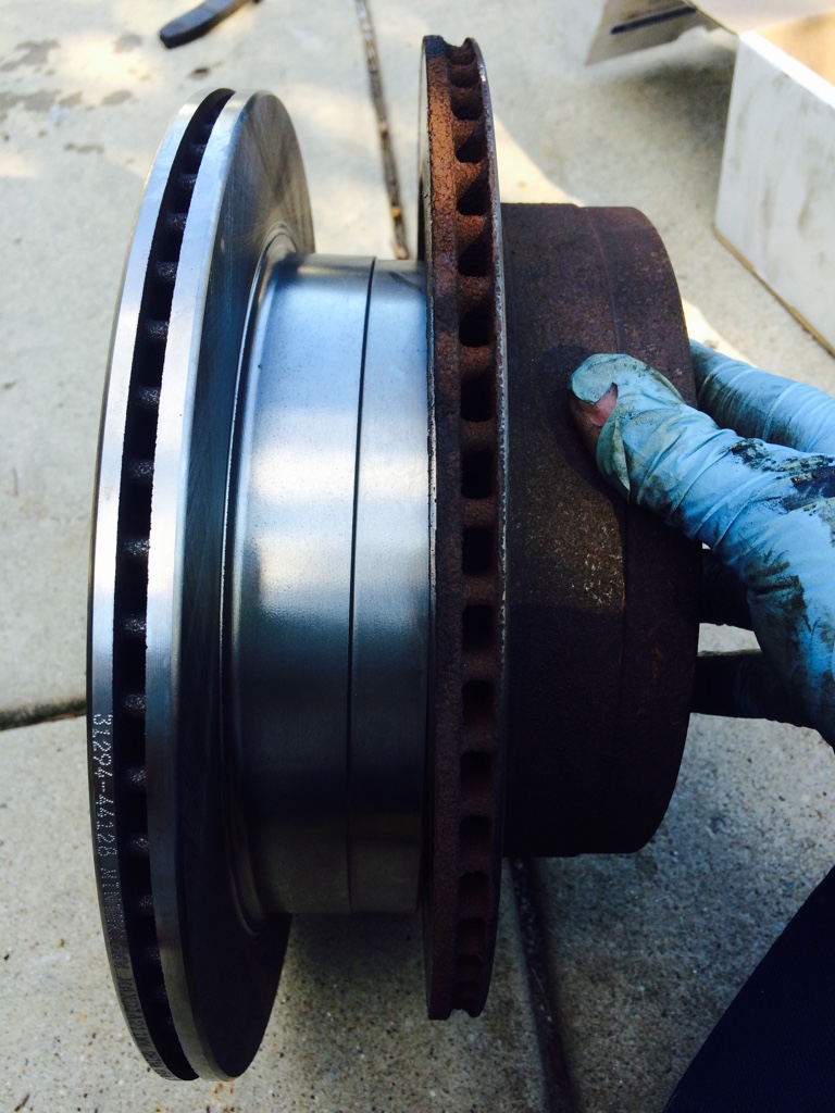

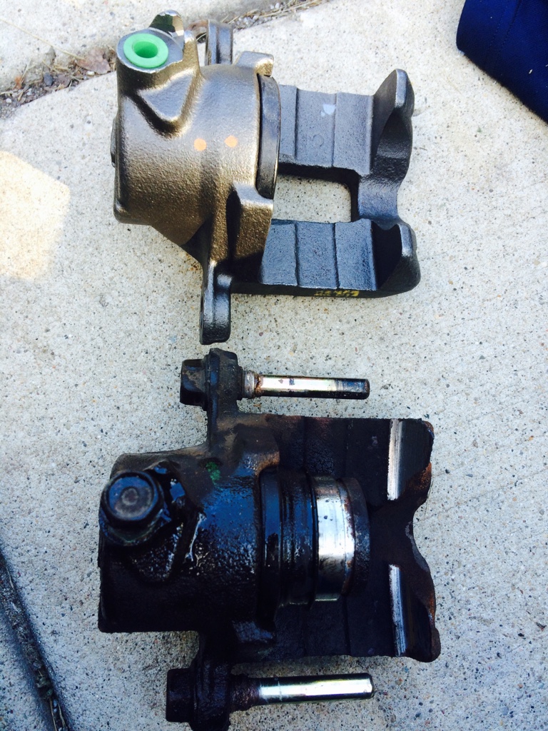

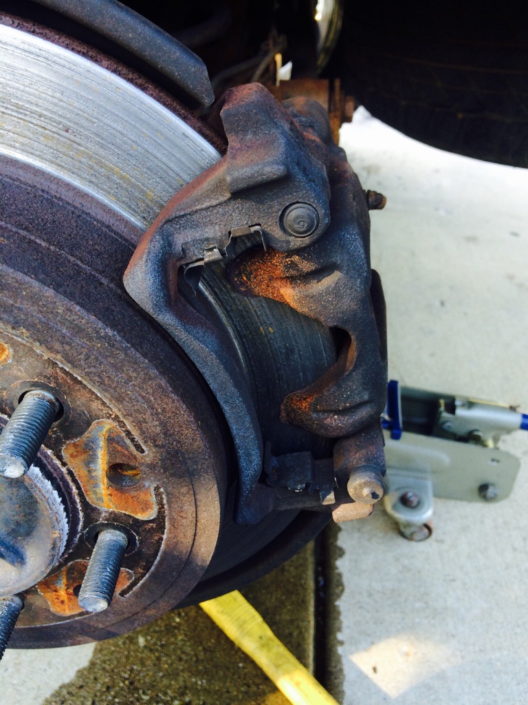

Took around 5 hours to change out and bleed the brakes.
The brakes got so bad that the fluid drained out completely. If that ever happens you'll know because your dash board is chiming and lite up like a Christmas tree.
Worked on one side went to bleed and the other just drained out everything, changed the other side then couldn't get them to bleed. Took like an hour.
But eventually got them fixed. Christmas lights went away as well as the warning chime.
Now the parking brake is messed up gotta change the setting. But that's for tomorrow.
This is my brothers car and as I stated. I yelled at for this because of how bad he let this go.
We're going to do his front probably next weekend or some what soon. Just to do them so they are all even in regards to wear.
