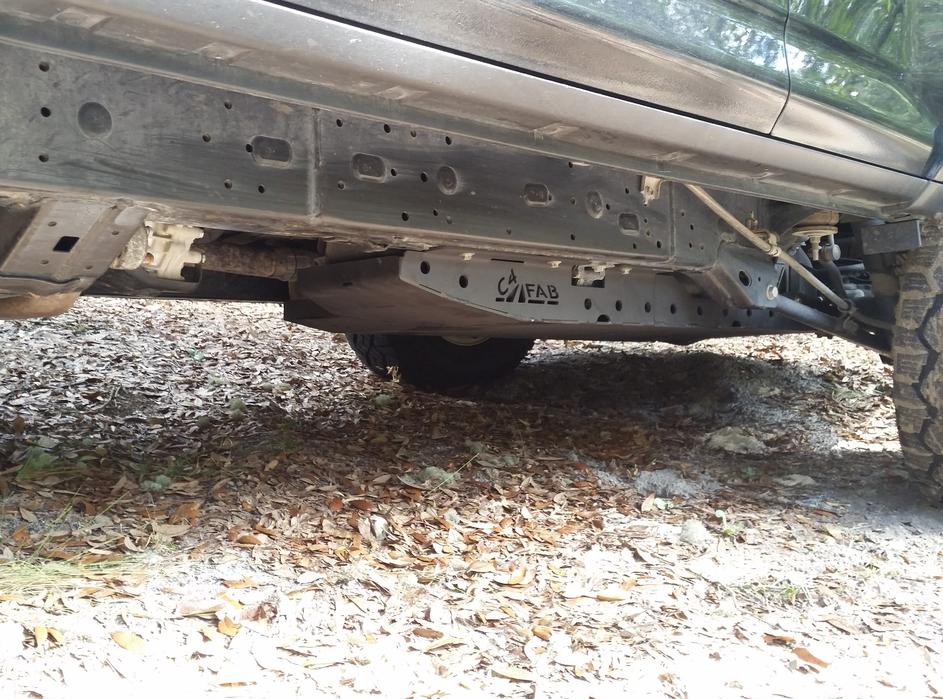

All the the gas tank skids I have seen are squared off here... And you lose a good inch or more of clearance since the actual gas tank curves in and sits further inside the frame rail in spots. I need to see if I can modify this skid to provide more clearance forward of the LCA. Or just buy another one if a better design exists. I want to take a close look at the c4 fab as it is the only one that looks very promising.. but if you know of others.. let me know. I have a RCI now.

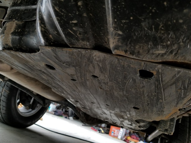

I used the stock skid - and welded a sheet of 12ga steel to the bottom of. Making a skid plate 2 or 3 times thicker than the frame rails just doesn't make a lot of sense to me. I just plasma cut a pattern to fit and cutout most of the drain holes too. Then welded around the drain holes to secure it. It aint pretty, but it works.
Fits as close as the OEM skid and so far as taken a beating, but held up okay. The weak link is the OEM support brackets and I might firm them up a bit. For your use (harder than mine)- you should probably do that before really doing much else with it.. Otherwise I think starting with the OEM skid is going to get you as close to a form fit as you can. I've noticed mine is a lot tighter fit than a few aftermarket ones I've looked at, but I haven't seen all the aftermarket options. I'll see if I have a picture.
edit: you can see about how high it sits relative to the lower link frame mount on the lower right of the picture. It'll take a side pic to give a better idea of how it fits compared to the aftermarket ones with a better direct angle.

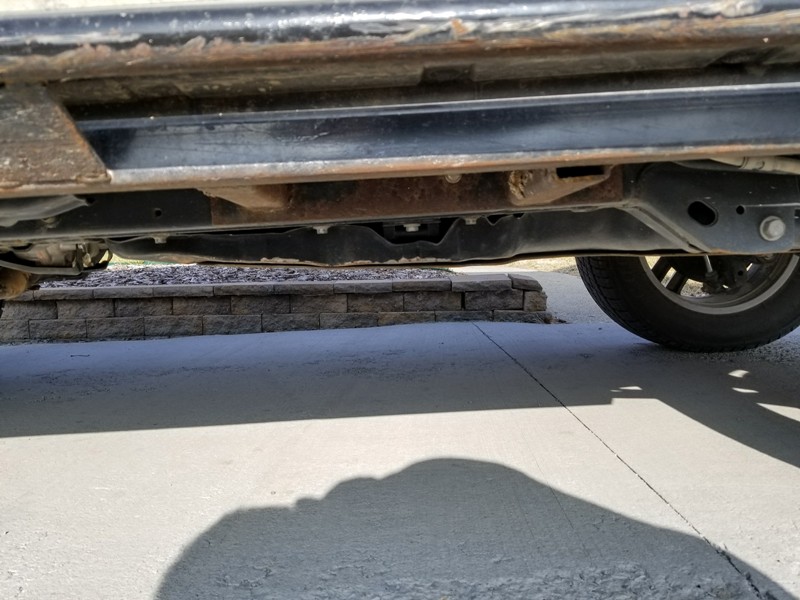

Here's a side view. It's basically just level with the lower link mount. It's higher than the transfer case skid though. That's my lowest point - and also removed right now for rebuild with more structure. I fit mine very tight and it flexed too much, so the next version of the transfer skid has internal gusseting.
