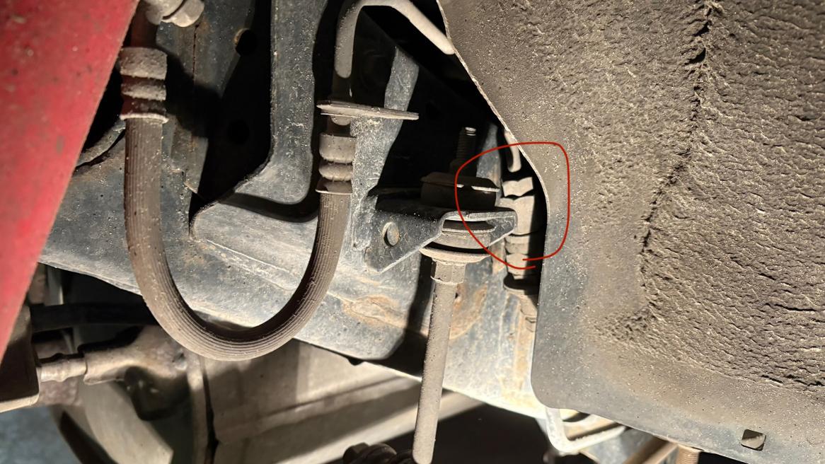

My Limited's X-REAS has been leaking for at least two years and the ride and handling had continued to deteriorate to where I couldn't ignore it any longer. It has 130K on it. Nearly 1.5 hours of the 9 were spent trying to reach and disconnect the X-REAS 22 mm valves, and remove some lines. I planned to leave all of the hydraulic lines in place, but that didn't seem wise from the Control Absorber module, forward. I say this because once disconnected, the connector valve of the front lines would have been hanging and possibly banging against things. I did leave the two Controllers and the lines back to the rear shocks attached to the frame, because they still seemed securely connected frame.

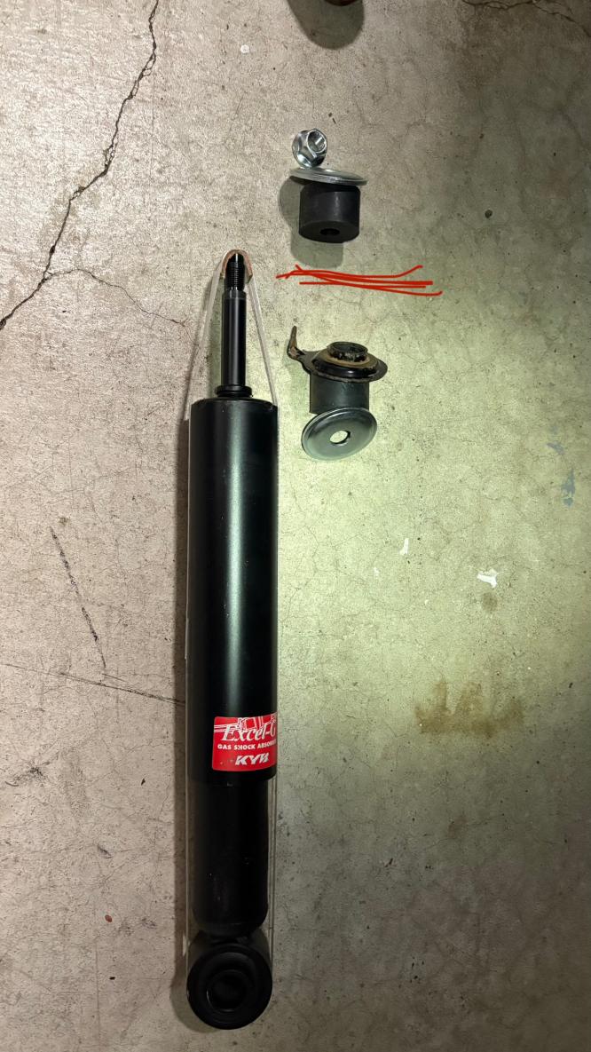

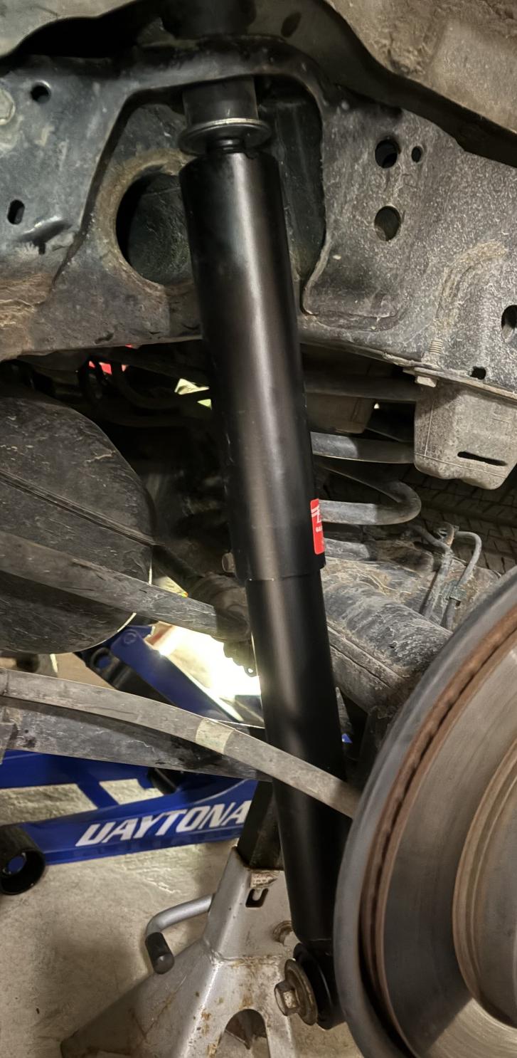

- For the new rear shock top mount assembly, I reused the factory metal plate (black) that has a spike in it which goes into the frame mount hole to help hold the shock in place. See the pic below with shock on the ground, and the red line is where the frame mount would be.

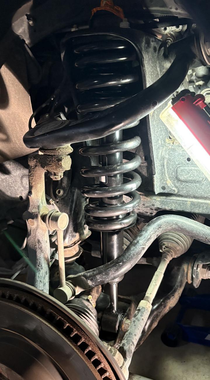

- I did NOT remove the front sway bar to get the old coils out and new in, but it probably would have helped. The old and new struts passed through, but did take some finessing in and out. Being able to lower the Lower Control Arm (LCA) extensively is what made it all possible.

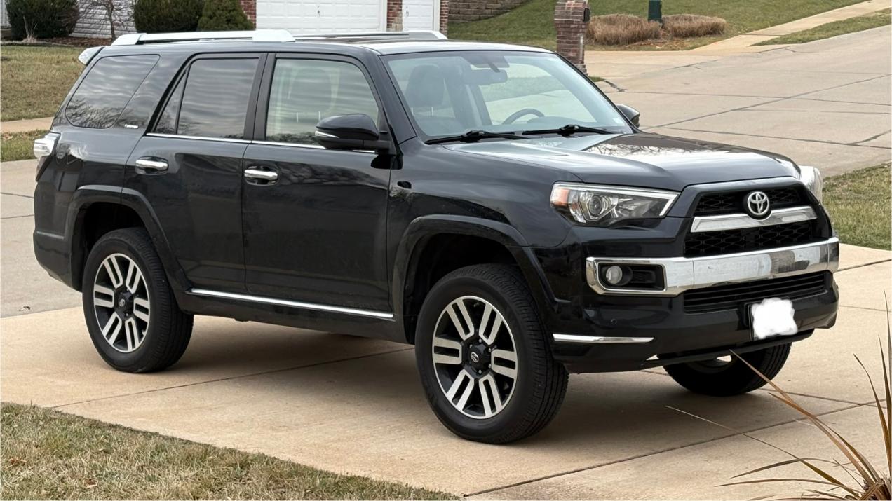

- The measurement at my front wheel arches jumped from roughly 34.5 to 36.5. Per KYB, these will settle .5 to 1". The rears stayed at 36.75. So, despite the warning from TCCN, I went forward with the install, and I'm keeping the Limited's coils in case I ever want to use them again. See pic below for the new profile, and you can decide for yourselves.

1 SR4529 Front Left Strut & Spring (Driver side)
1 SR4528 Front Right Strut & Spring

Pics 1 - Rear X-REAS connect and rear shock assembly

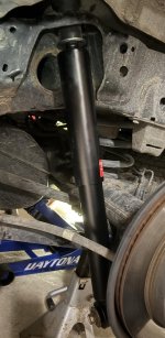

Pics 2 - Rear and front KYB installed + new stance
