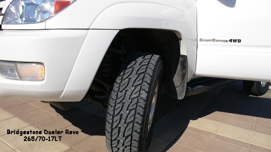

Any close up pics of the tread ? or just on the trucjk in general?

Here is how the tire looks on my 4Runner.

I thought the E's were more agressive than the P's hard to tell from the pic but they dont look any more aggressive then my P's do , just a hella lot stronger I'm sure. They still dont look aggressive to me for an all terrain. Guess I'm used to the BFG look which have bigger lugs , deeper tread.

Thanks.......I've never been one for the white letters on the outside but that doesn't look to bad, maybe because your truck is silver. I think it might stand out more on a dark color.
