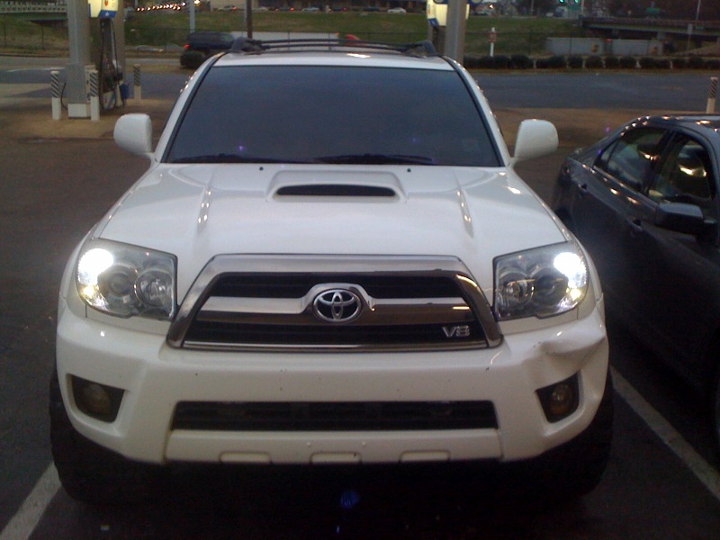

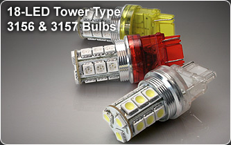

An '05 has a 4157 (3157) bulb for the front turn signals (w/running lights) and 7440 in the rear. There is not a really bright rear LED bulb but for the front there is, here is a pic of the bulb from Superbrightleds.com. Also, here is a pic of my '06 with the same type bulb in the daytime running lights/ turn signals (when my bumper was messed up) during the day; have pics of them at night on the second to last page or last page of the lift.tire pics thread. They are great but make sure to get a resistor so they don't blink really fast. I would leave the stock rear bulb because with it your really not going to get a good light output with the LED's
