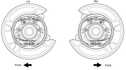

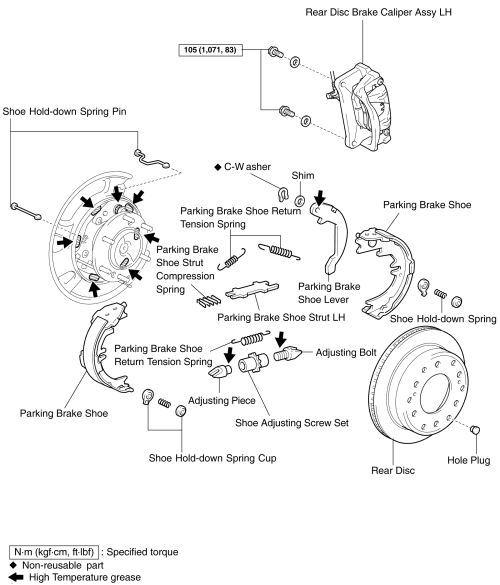

These are a couple of pics from their section about the parking brake. This might help you to ensure that all of the parts are there anyway. Hope this helps!

Just did mine last weekend and had the same issue. The back hold down spring rod is not straight and if the parking brake pad is caught on the rotor it can lengthen it (un-bend it). I used two flat head screw drivers and gently put it back into position by holding the back and pressing the front of the pin with the spring and cap in place. This gave me the clearance I needed. You can see the shape in the diagram below (the back shoe hold-down spring pin).
