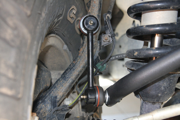

I have an 08 sr5 with a toytec leveling kit. The right sway bar end link keeps going bad and breaking on me. I have replaced it 3 times now under the parts warranty. The last one I put on was a Moog brand replacement.
Does anyone have any advice on why one side keeps going bad? ..I have already changed the sway bar bushings. Thanks

It is not physically breaking in half. I am guessing the joints are going bad inside the rubber bushings causing banging and a sloppy suspension.

You're sure it's the sway bar link failing and not the sway bar having slid to the side and contacting the coilovers?
It's something you see more on lifted 4Runners because the sway bars tend to get relocated and the aluminum collars that "locate" the sway bar in the middle of the vehicle get loose and the bar can get pushed by bigger tires to the left and right on tight turns. Then when the suspension articulates it catches the bar and can "bang", "pop", and/or "clunk".
This was happening to me on my 4th gen, but my coilovers are a bit wider than the factory set-up if I recall:
I forget where I posted the "fix" but I ended up buying aftermarket sway bar collars (they were for a Jeep if I remember right? I forget the size) and just centering the bar and then cranking the collars down. Haven't had issues with rubbing/squeaking for a while.
