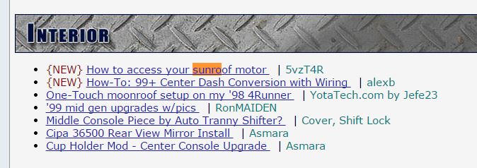

The sunroof motor is easy to swap and does not involve removing the whole "sunroof assembly" since the motor is located in a different spot, near the front map lights area.

Here--->
http://www.toyota-4runner.org/3rd-g...faq-tutorials-documentation-reference-v2.html
More specifically here:

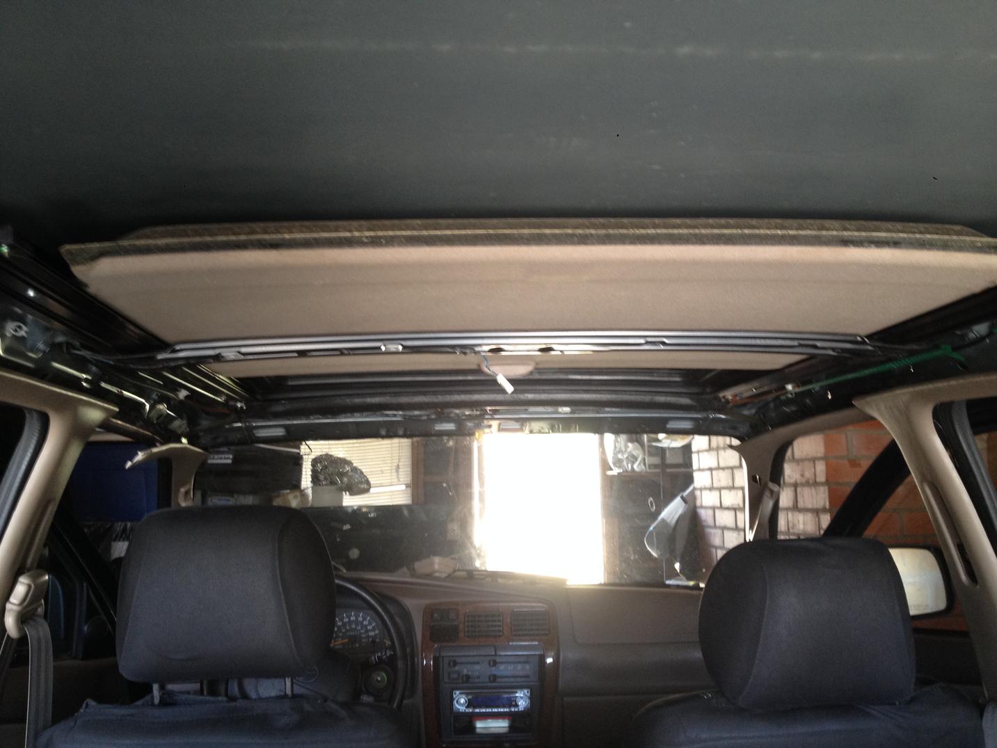

I just finish swapping out my complete sunroof assemble due to the cable being worn out and not opening. It not a bad project to tackle only 2-3 hrs or less.
I have a good motor from a 98 if u need, generally it's plastic warm cables not motor I have repaired a few not bad about two hundreds for both cables 3/4 hr job plus beer
here is a the only picture I took during the project, didn't think I was gonna post it up (sorry forgot) not very hard to do.
