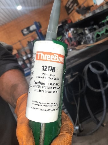

This is probably better then Toyotas FIPG
[This specific one is for engine seals...]
Threebond Form in place gasket.

I am not trying to knock Toyota FIPG. It's a good product. It's just as time goes on new products can be used in place of granted if they are fir the same thing. :)

Not knocking you for sharing. I went to do research and found 1217G specific for transmission case use. I appreciated your post

I didn't think you were. I just wanted to add it as a possible option instead of toyota fipg. :) which works very well too. :)
Lots of high performance engine rebuilders use threebond products. You are correct I need to specify that ones for engine. Good call. :)
