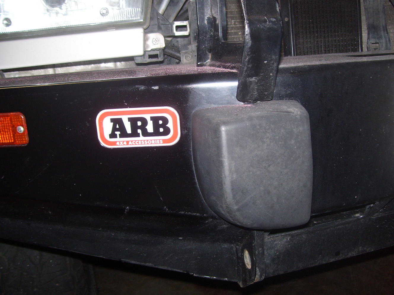

Recently picked up a used ARB a few weeks back and the powdercoating has seen better days. It has some scratches and is faded pretty bad.
After doing some research I dusted off my Porter Cable 7424 and found some Meguiars 105 Ultra Cut compound on my shelf of goodies. As the powdercoat is pretty tough I couldnt get all the scratches out, but it brought back the black and put the sheen. Pictures dont do much justice, but you can see to the right of the ARB emplem is as far as I went. Push pads are pretty dull too, probably use some Back to Black on those.

Give it a shot. Here is the link that I found recommending the Meg's 105.
http://www.autopia.org/forum/car-detailing/114412-can-i-polish-powder-coat.html
I am by no means a detailer, just had some stuff leftover from when I had my BMW M3. Its almost too shiny now, but looks way better than dirty faded black. I will be finishing up the entire bumper today and will post a pic.
