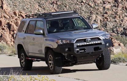

The ugly brush/bull bars look tough but don't give any pinstriping protection down the sides.
Maybe something like this member's setup. Megaweapon [MENTION=137107]Ray Dunakin[/MENTION]

although mega weapon's bumper is bad ass, it will not protect your head lights from getting scratched up... which isn't a huge issue for Ray since most of his pics are in desert terrain. If you have a lot of over growth, your going to want hoops around your lights to prevent scratching also, if you can get a bumper that isn't a full replacement, it will be lighter and easier on your bakes.
