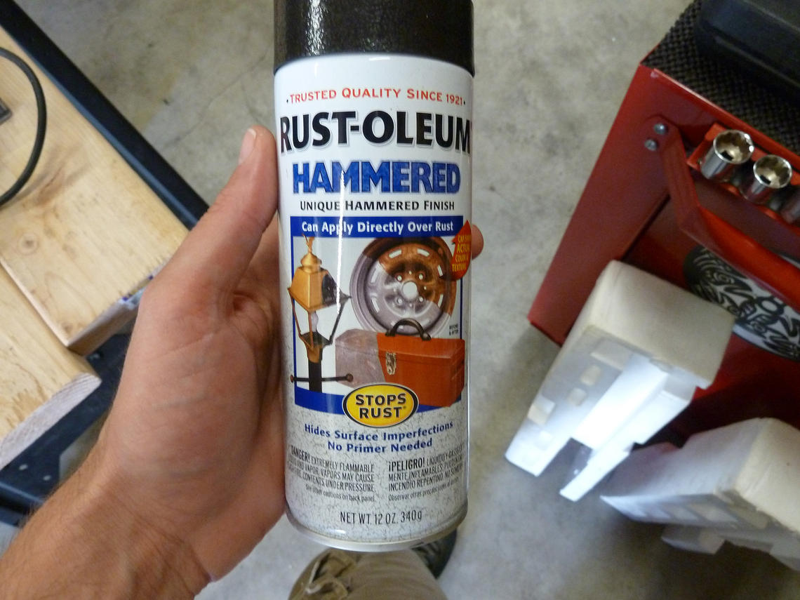

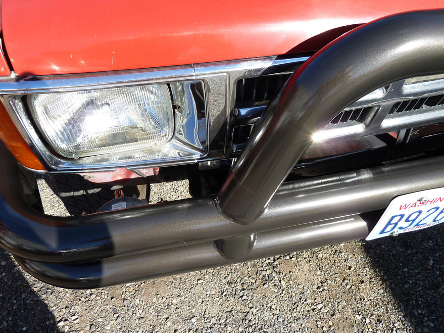

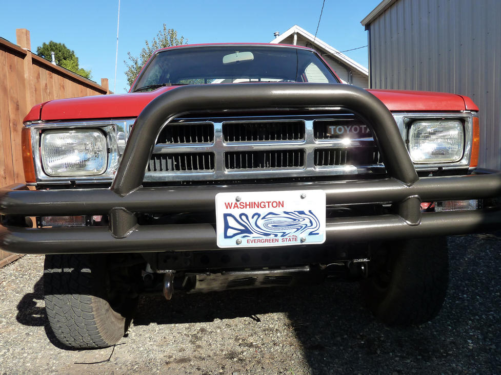

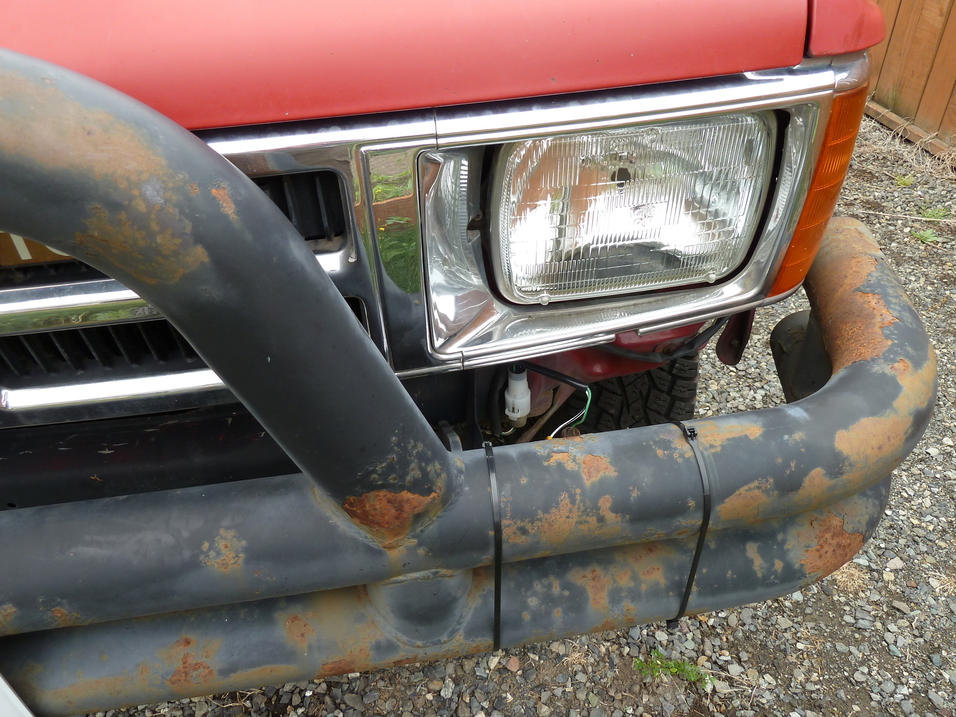

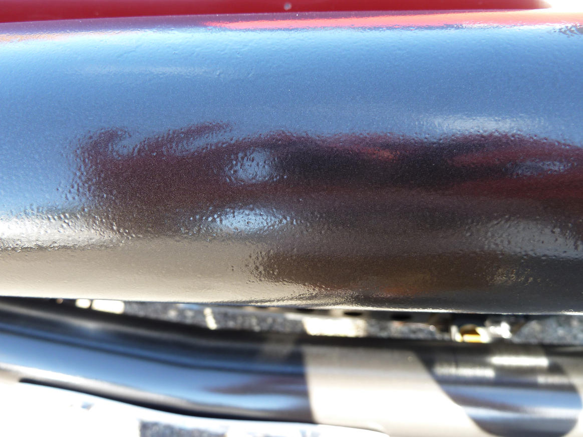

I just painted the smittybuilt bumper on my pickup with rustoleum "Hammered" paint. I thought it was black but turned out to be a dark, graphite grey. It looks totally bad ass, I almost didn't use but figured what the heck. Best thing about it is it looks like a hammered finish and seems really durable for a rattle can job. I can snap a picture of it if you want.
Sure I'd like to see it, Graphite dark may go really well with the finish I have in mind for the 4runner.

One thing I would reccomend if using this paint is to keep going with light coats after your first coat. I started going heavier and heavier because this paint has very little tendency to run. What that ended up doing was making a hammered pattern over the top of first coat breaking the pattern up into a smaller more of an orange peel type look instead of the initial deeper, longer hammered look it had after 1 coat.
