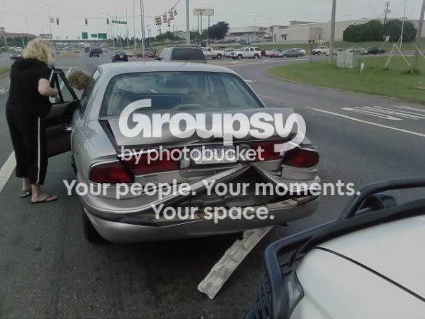

bumperwreck.jpg~original
Hit the back of this car with a "brush guard" at about 10 mph. Damage to my rig - slight dent to the chrome bumper and a scuff on the fender by the corner light where the headlight guard section popped back. That's it. Nothing else. The guard was mounted to the front of the frame, and through the bumper with "L" brackets. If it was just mounted to the frame, like these are, it would have easliy folded back into the grill, hood and fenders.
