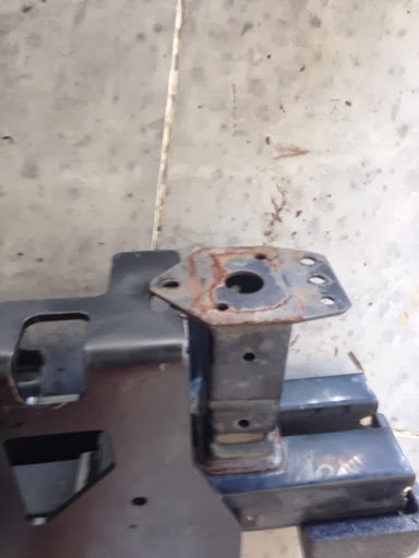

This plate will mount inside the stock front reinforcement. So once you remove the front reinforcement (4 bolts each side) you need to slip the Bud Built plate in between.
Depending on the age of you truck you might have some rust/corrosion like I did on the stock front reinforcement. I wire brushed the inside but still a tight fit.

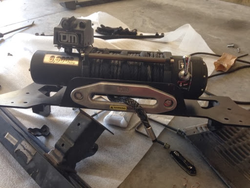

Once you know everything will fit together you need to mount the winch to the plate, then slip the plate back into the front reinforcement. The reason being as 2 of the winch mounting holes are between the bottom of the winch plate and top of the stock reinforcement.
So time to mount the winch to the plate.

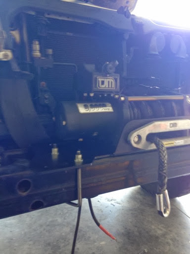

Here is the plate mounted to the truck. I wasn’t feeling well so I just used my phone. Didn’t want to take out the DSLR.
Here is with the bumper back on.
I trimmed out the whole lower grill. Looking back I should have left the sides in and just cut out the center. But maybe I can make something to cover some of the crap on the side. Unfortunately without some grill material in the lower grill you can see all the stuff off to each side.
Product is good quality and fits well. Corrosion and rust will make the install slightly more difficult. I ended up breaking loose 3 of the 4 front OEM reinforcement bolts/studs (on the passenger side) when I slipped and twisted the setup. The bolts were just not that strong. So I was off to Ace to get some grade 8 hardware to replace them. In reality it made the install easier.
I haven’t finished the wiring yet. I would suggest that anyone looking at this setup get a winch with a removable solenoid kit vs the integrated. I am keeping my solenoid attached to the winch, but slightly sideways. I have a wireless remote anyways so I only need limited access.
When it comes to the free spool lever. You will want to trim the inside of the bumper cover a little. That crisscross pattern on the back will interfere with most winches once installed. Or you can re-clock it if needed. Currently i have access from the top and front. So it works just fine.
If I was feeling better I would have taken more/better pics. But honestly glad the install is done. I would highly suggest having friend help. I completed it by myself, but would have been easier with a 2nd set of hands
