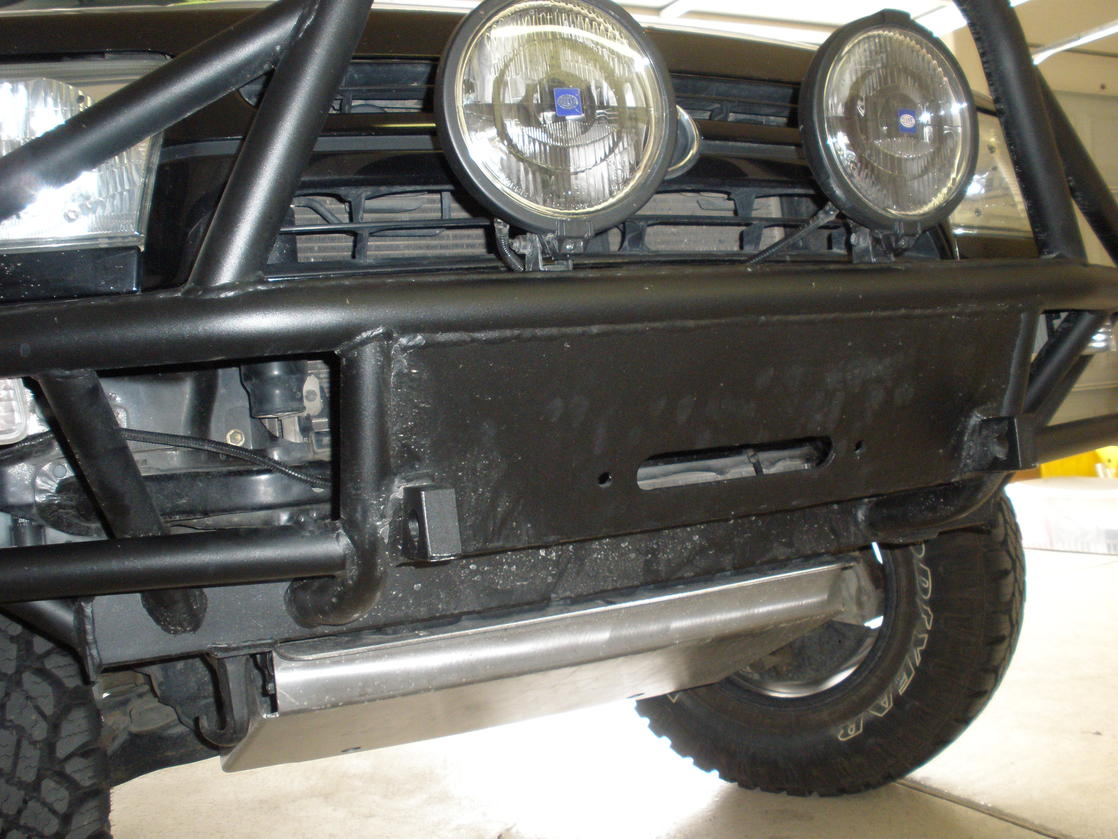

budbuilt pic
Bomber, easy to install, haven't taken a hit yet but I'm sure it will
good company to deal with
