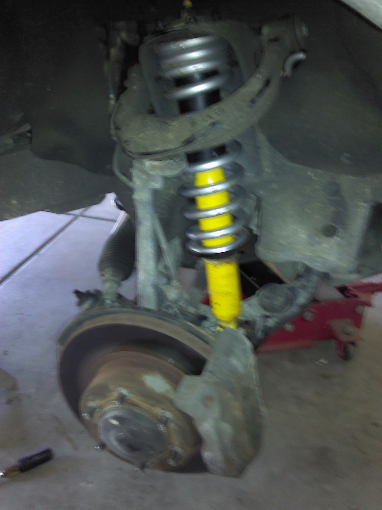

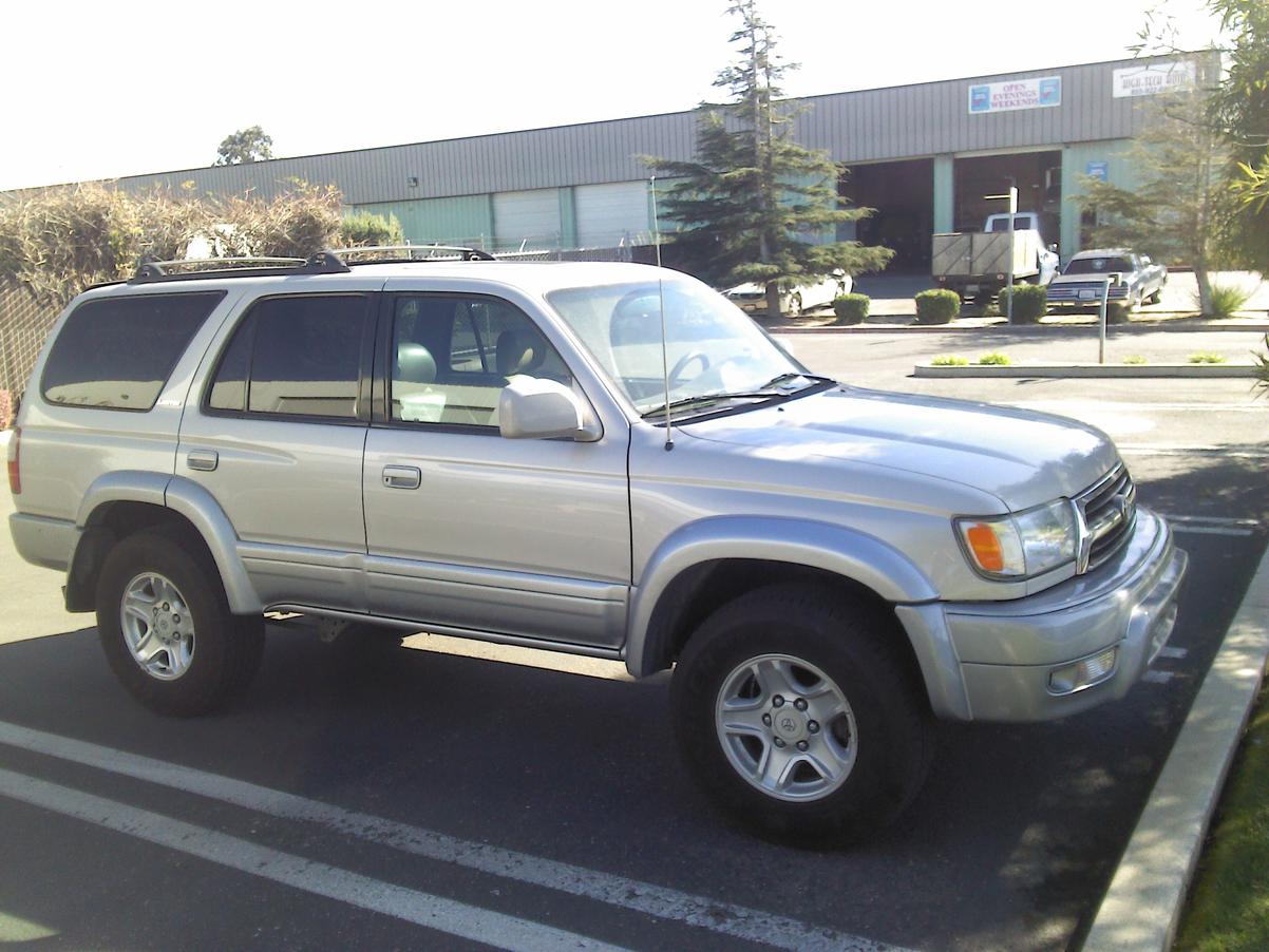

Finally installed my lift this weekend. Due to tight finances, I started piecing this together about a month ago using the classified section on this site as my parts source. I know it's nothing special, there's some killer setups all over this site. Just wanted to show that it doesn't take a lot of cash to build a decent rig.
Parts / Price:
Rear OME 890 coils / $100 (thanks 48HMSFAN!)
Front Performance Products coils / $80 (thanks 1985taylor1925!)
Front OME N91S struts / $40 (thanks Weejub!)
Rear Skyjacker Hydro's shocks / $85.95 (ebay)
Parts total: $305.95
Labor for strut assembly and alignment: $100
Grand Total: $405.95

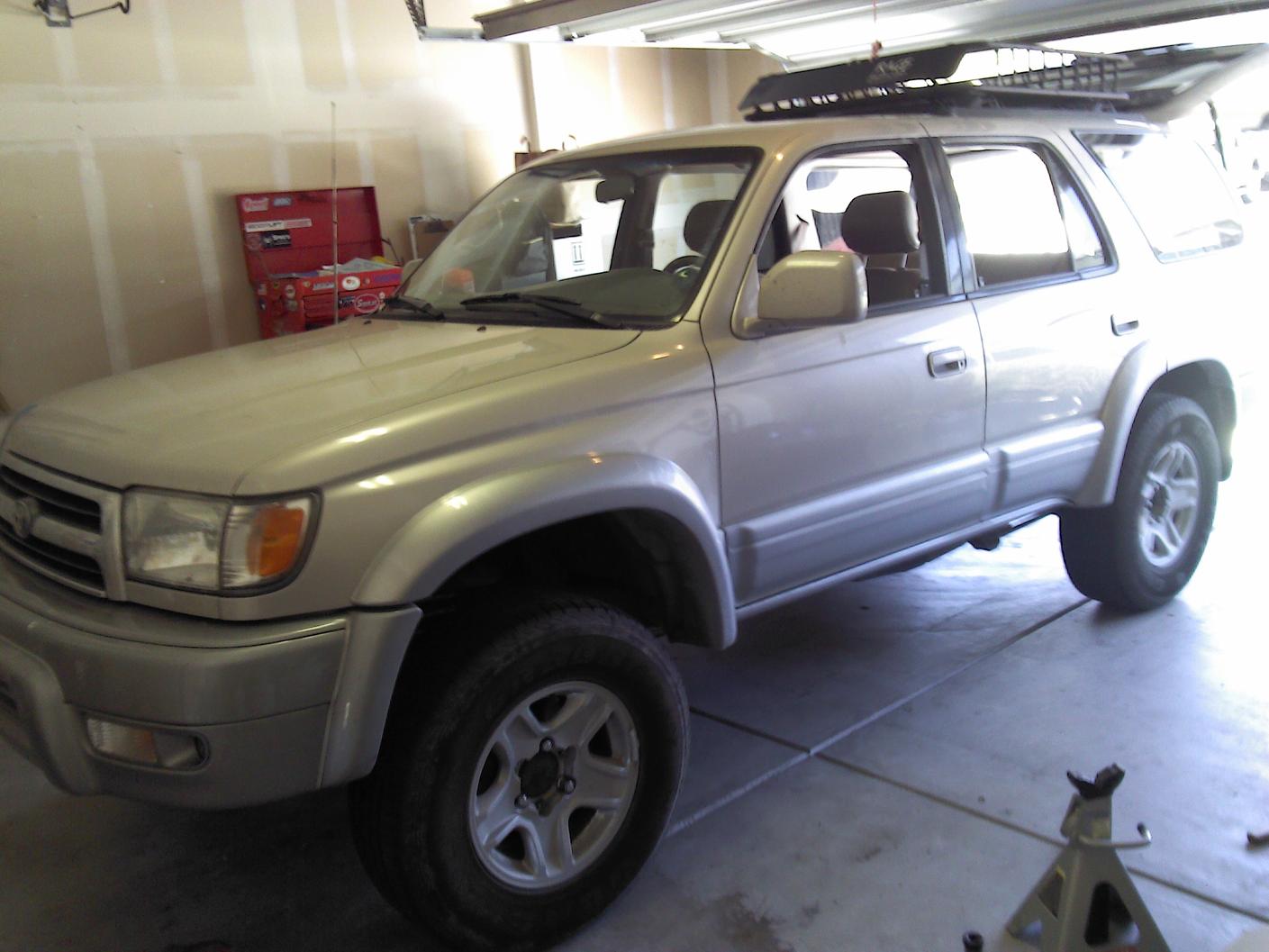

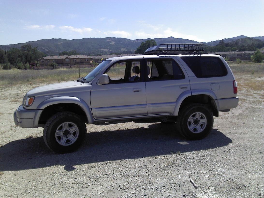

Installation took about 3 hours, and netted almost 2.5" in front and 3.5" in back (granted original parts had 200k miles on them and were severely sagged). It may be a little Frankenstein-ish, but it actually handles really well! I'm very pleased with the way things turned out. Huge thanks to the T4R members listed above, they were all very professional and I wouldn't hesitate to do business with them again. Now.. anyone got some tires for sale???
Not much of a pic taker, but I managed to snap a few sh!tty cell pix.
Before: original.jpg
Front strut assembly: strut.jpg
Front installation complete: front.jpg
Finally done!:complete.jpg

That's awesome man. As I am also tight on funds(fancy way of saying I'm broke lol) this is gonna be my bet at getting a lift put together.
Glad you got it all together man! Looks good.
