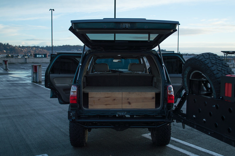

Rear Bumper part 1
So I have been wanting to put a rear bumper on the 4Runner, mainly to mount a spare tire and gas can holders. Plus, I was tired of looking at the dented bumper. So after pricing aftermarket bumpers, I decided maybe I'll try to build my own for a low cost. I found a good deal on some plate metal, 30 sq ft of 1/4" for $150, here locally that would be closer to $350 from the metal supply. I don't really want/need 1/4" as I found out it is super heavy and kind of hard to cut. I also found a good deal on a section of 5" square tubing, that just needed to be cleaned up.
Extremely DIY bumper "kit":
The Wife got in on the work too
Hitch came off first, the hitch probably weighs about 40 pounds
The bumper was a pain, and probably weighs 40-50 pounds with all the brackets. [MENTION=159759]Spunky1[/MENTION] came by to help as well.
Next we mounted the tubing section and started welding mounts
Then the fun part of cardboard shapes
Using an outstanding(ly cheap) Harbor Freight Angle grinder and some cut off wheels the cutting began. Very slowly... I know this would be a lot faster if I had plasma or a cutting torch or CNC/Water, etc. But, I don't I'm on a budget here, so this is what I got. It works, just takes a while.
I think it's turning out great. I stopped here because I smoked my angle grinder. I specifically bought this cheap one to use and toss because it's cheap. I didn't want to ruin my nicer one with this project. I am using a friends bigger, better welder to finish it out tomorrow. I do want to add a hitch in the middle and some lights on the outside. I estimate that this bumper weighs around 120 pounds, maybe a little less. I could use a plasma cutter after it's done and cut out a lot of the 5" tubing underneath/inside to save weight.
Coastal Fishing Trip and Bumper paint
I wanted to finish welding and paint the bumper before going to the salt water, but it didn't happen. We had a good trip and the rooftop tent performed flawlessly.
After we got home, I wrapped up the bumper, for now. I still need to add a swing out tire carrier/gas can holder and a hitch.
I feel good about building my first bumper. Not as bad as I thought it would be. It's not perfect, but my whole build is A: built, not bought and B: Function over Form, with as much form as reasonably achievable.

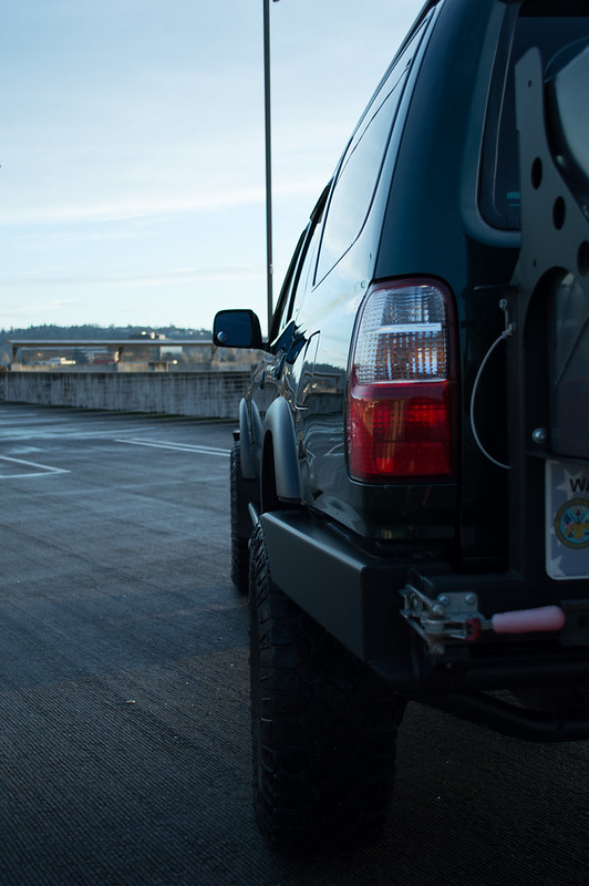

Tire carrier part 1
I have been waiting for my Comp 4x4 Hinge to come in and also my De-Sta-Co latch. Everything is in and I got planning. I want to be able to mount 2 5 gallon fuel cans on the back. The Comp 4x4 hinge is beefy and worth the wait.
I initially got the VP racing 5gal "off highway" cans, mainly because of the nozzle. No CARB compliant BS here. CARB can kiss my ass with their stupid fuel spilling nozzles. How are those even considered to be more environmentally friendly if they spill fuel everywhere? Anyway, the footprint on the VP cans is just too big for the back of the runner. They are roughly 10 x10.5". Both of my Milsurp cans are 13x13.5" and the same height, for twice as much fuel.
After collecting the necessary materials for a cool $55 (more metal than needed, as usual), it was the nice warm part of the day.
So I have a hard time planning a lot of this stuff out, because I just visualize it and then make it.
Forgot to take more pictures towards the end, but here's where I called it a night. I will mount the spare on the driver side and gas cans on the passenger side. I am going to make a "wire" frame for the cans out of 1" flat bar. I ordered a 17" steelie that should have enough backspace to allow the 285/70R17 spare I have to fit on the front.

Gas can holder
Been busy with other stuff, specifically not being outside roasting. I did get a gas can holder made. After looking around and pricing them, I decided to make my own.
I also got my spare wheel in and got my tire mounted. It's just a steel wheel that should clear the front suspension in case I need to put it on the front. I should have just ordered a matching FN wheel, because this steel wheel is HEAVY (37 pounds)!
Here is how I'm thinking it will all fit on the back. I will mount the gas cans a little lower, I think. I have a bent axle shaft that I think I'm going to cut off for the tire mount.
Next week hopefully I'll get it done.
If I were you, which I am not, I would re-evaluate the use of the latch you've got, how you've got it.
I've only ever seen them used when there was a little "seat" that the swing arm sat on top of, and then the latch simply held it there. By doing that, the "seat" was supporting the weight of the swingarm, and the latch was just holding it in place. I think once you ad that spare tire and those two fuel cans you're going to be putting a LOT of unnecessary stress on both the spindle, and the latch.
Here's a picture of my CBI for reference... Not the best picture, but i think it makes sense.
5 by Alex Wilson, on Flickr
9 by Alex Wilson, on Flickr
Thanks, yeah I looked at doing the latch with that style, but for the design I had in mind, I think this will work. I am going to add a little perch that the swing arm will sit on and the latch will just hold it. It's a double shear hinge, so I think it will be fine. Thank you.
Excellent work with the rear bumper and swing out, I love the simplicity. Im hoping to start on my swing out this week.
