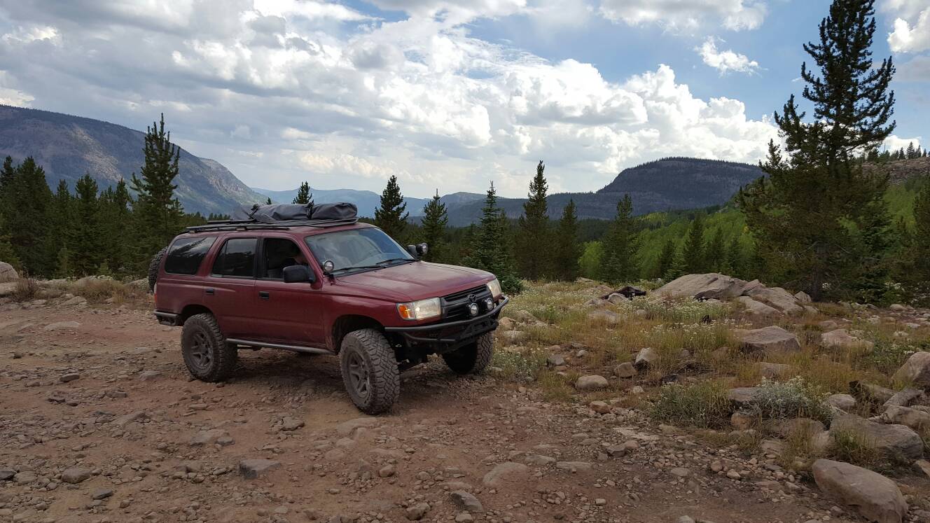

Current pic...

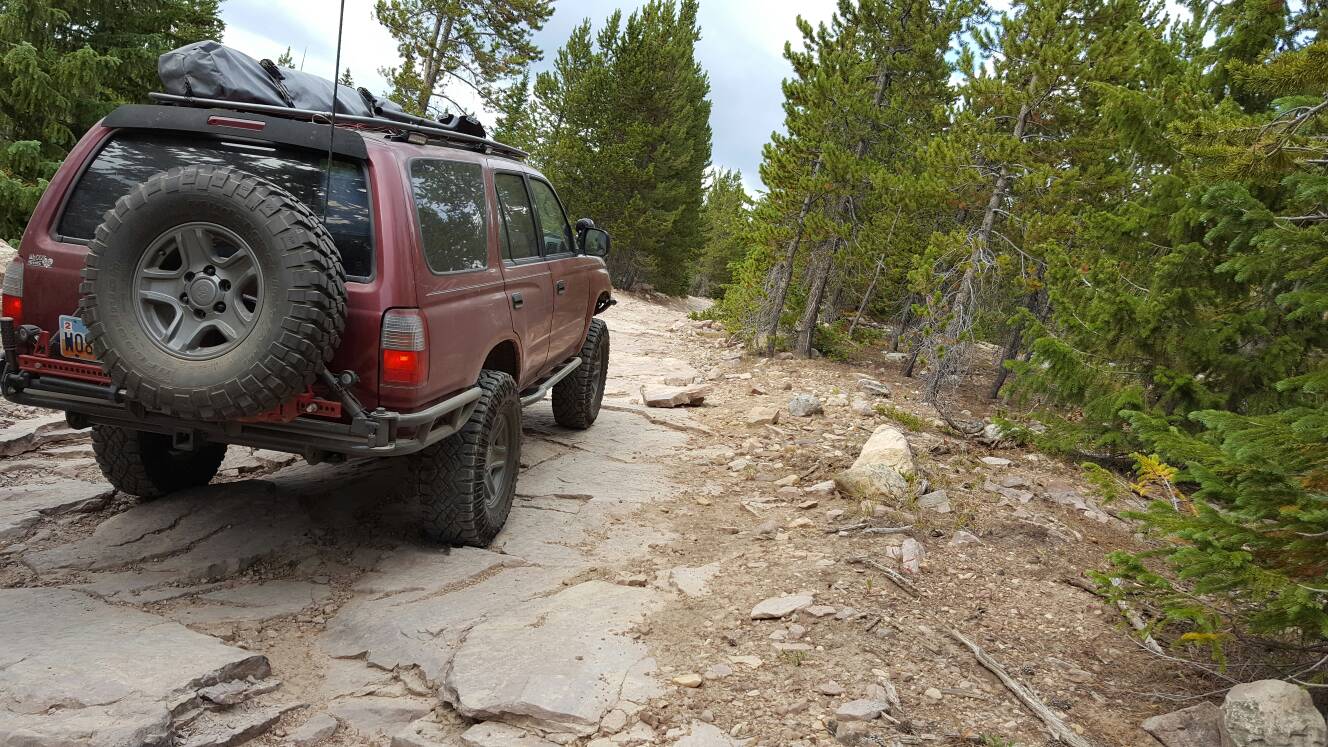

Some other pics along the way (no particular order)...

- Savage rear tube bumper
- Booty Fab tire swing out

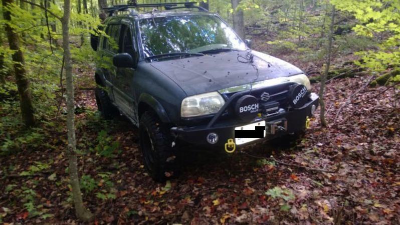

My latest rig was a Zuk. Here it is. I really loved this little truck, it was tons of fun.

Here she is in all her new-to-us glory.
Nice to see a fellow Zuk dude around here. My previous rig was an 01 GV. Awesome little truck but I grew out of it. Still have it though, at my buddy's up north. I like to take her for a spin every now and then!)))
