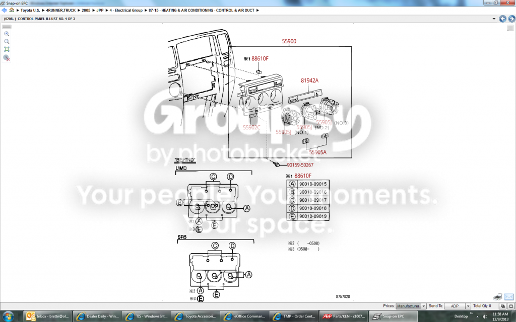

The link above is for the Heater and A/C bulbs. I think he wants the bulbs for the mileage calculator and clock. Those are different. See pic below. He needs C's and D.
