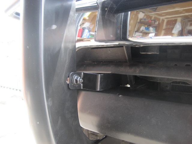

replaced all the hardware with grade 8 bolts (after a few of the crappy bolts snapped). In this picture you can see the lower brackets that attach to the tow hook/tie down locations. Originally this is the only bracket i installed, since Hunter told me the other bracket was for the Tacoma...

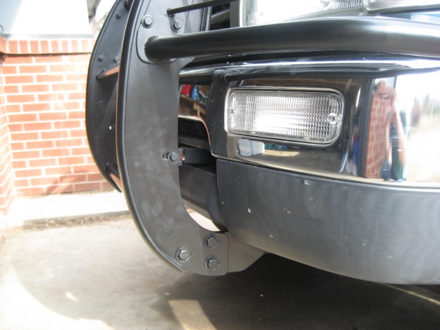

The bar shook too much for my liking with just the two bottom brackets, so i decided to make the other brackets work. I had to cut out the lower plastic insert for the bracket to fit through. Took 5 minutes on each side with a skil saw. This upper bracket bolts to the frame as well. There was a preexisting hole in the top of the frame rail, but i had to drill a hole in the bottom (where the "indentations" where). Took a few minutes for each hole with the right carbide tip drill bit..

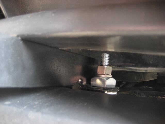

top of the bolt that runs up through the frame rail to secure this upper bracket. I used 5" grade 5 bolts.. but 4 1/2" would have worked just fine (didnt want to go back to the hardware store to get shorter ones). I had to use spacers in order for the bracket to be lifted up and clear the plastic bumper. I used a square nut that was to big and a washer on top, this provided just enough lift to clear the bumper and still line up with the grille guard.
