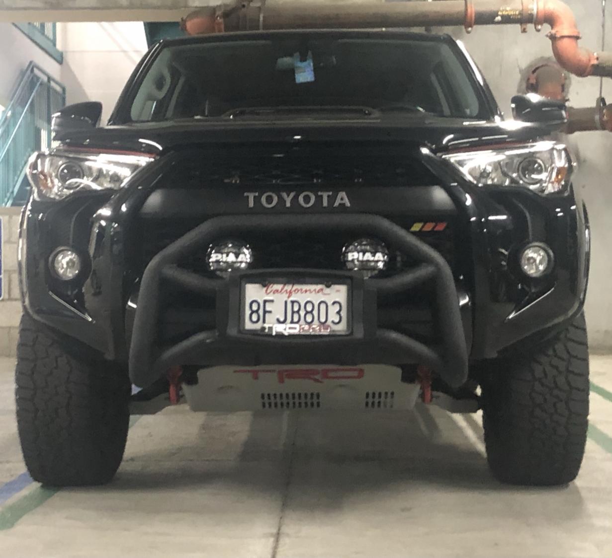

I ran this Tyger bull bar for 3.5 years until very recently when I got my Warn LoPro bumper.
Here is a pic. I thought it was a nice looking bar.

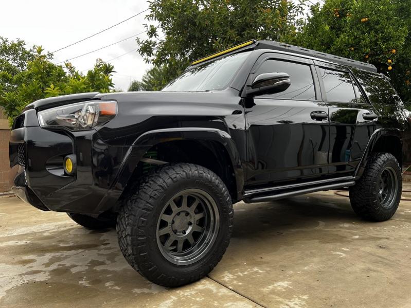

My limited doesn't look like a limited anymore.
Yeah this would be ideal. Ill see what they say. Their site claims it wont fit limited but it sure has a lot of holes and im doing pod lights not a bar. Got any pics of yours? Ideally I would change front end to a SR5 bumper or similar to get hidden winch. But was also thinking about getting winch on rear hitch mount as well so I can remove when needed.
My little limited, SR5/counterfeit pro front, ORP rear, and limited rockers cut in half.

Nice! I took off my rockers as well. USed the shrockworks metal strip for a fill plate and the end cap. Made up some custom universal mud guards and all is well.
Can I ask rough cost to switch to SR5 front end? What year is yours again? Any issues with the SR5 swap out?
I did not get all the info on my own, I read Fatbikehauler's thread and a couple of others to get the main ideas and parts down. Plus/minus what I need and didnt need. Some great information to be found on this site. Thanks for all the help and ideas!
Parts cost depends on what you really need and the condition of the items. I went used almost everything. I waited and searched almost everyday to find what I needed. All my parts I found in black, didn't need to spend the cost to paint. Saved a few hundred just right there.
Used bumper about 200
Used reinforcement beam 100
Used rear bumper 150
Used rear valence 40
Lower grill is new aftermarket 50?
Under headlight brackets new 50 each?
New fog light shrouds 40?
Everything else was either moved over, cut out, or modified. If you're handy, you'll figure it out.
Finding paint matching parts in good condition was the hardest part.

I showed the pic of the Tyger Bar to my wife (her 4Runner) and she did not like it. I was thinking of it for some protection from deer strikes. Not a fan of the full bumpers with bars wrapping around the lights. More likely would be a center mount with winch, but I can’t even get her interested on those.
