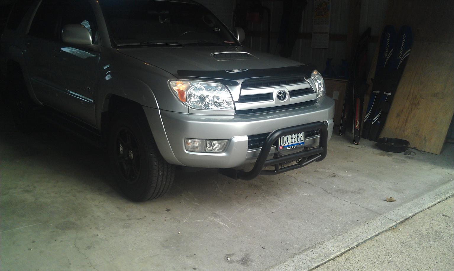

I have one of those bull bars from ebay. Ya it was cheap, but I like the way it looks and holds my fog lights very well. Install was very easy and it lined up great. I do know that it will offer almost zero protection if I hit anything with it but it serves my purpose of holding my fog lights. Here is a pic of when I first installed it
