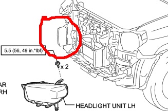

I'm repairing my front end after a hitting a deer and I have found all of the necessary parts except I cannot find this plastic support piece for the bumper cover circled in red, any input is appreciated.
Thanks

^ I've seen that piece before. I don't think it really does anything. It doesn't attach to the bumper cover. I think you're fine without it.

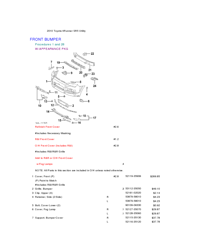

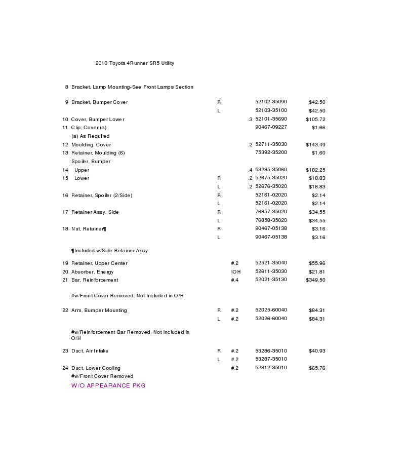

Pretty sure they are #9
Bracket, Bumper Cover
R 52102-35090 $42.50msrp
L 52103-35100 $42.50
They are to direct airflow to aid in cooling and support the bumper cover.
Pass side is Right side.

#9 in Harper 7's picture is a metal bracket that bolts to #19. They are upper bumper supports. If you are looking for the plastic deflectors, they are #15 and #16 in this picture.
ToyotaPartSales.com
You are correct....my bad.

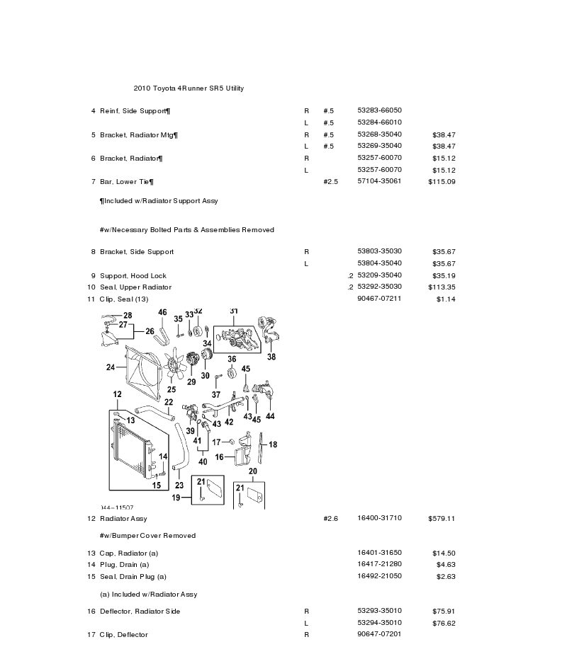

Deflector, Radiator Side
R 53293-35010
L 53294-35010
