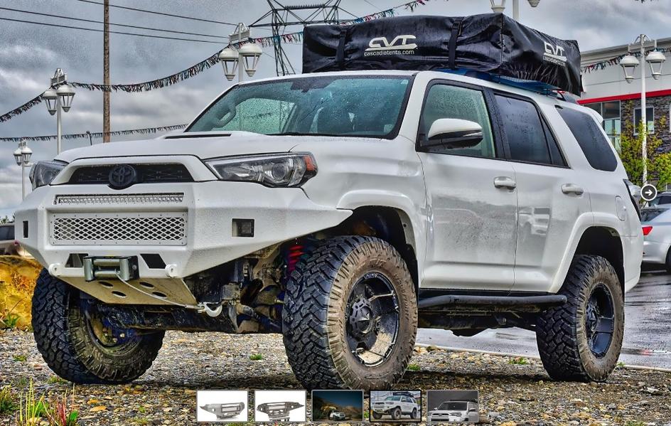

Eg. Pelfreybilt is local to me and doesn't involve cutting the stock parts, ie. the bumper comes all the way up to the lights, but there is no bull bar or hoops. It also comes in aluminum, which I might consider ($300 premium).
I love the look of the bull bar/hoops models, but being made to fit and the aluminum options are attractive.

Pelfrybilt, this one painted white:

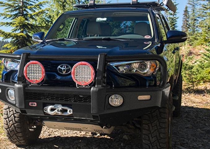

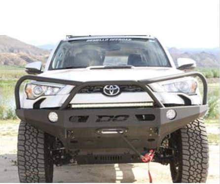

Here is a DeMello for comparison, and an ARB:

As far as I know ARB is the only aftermarket bumper designed to work in conjunction with the factory airbag system. They've actually tested their bumpers in crash tests but I'm sure with all the other brands the bags will deploy depending on the speed of the crash
Most of the brands have the washer reservoir and hard lines exposed but I believe Pelfrey makes a shield for the hard lines and Shrockworks has an optional shield for the reservoir. Of course you can leave the reservoir as is since it's made of pretty beefy plastic.
I'm not a fan of the Pelfrey, Metaltech, Proline "no-cut" bumpers as they look too blocky for me. I prefer the "cut" bumpers like the majority of options out there. You'll need to make sure you use a jigsaw with the right blade to get a nice straight cut. Measure, re-measure and measure again before you cut.
All this means is that they are designed and tested such that the airbags won't deploy during light frontal impacts. They have custom crumple zones built into the bumper itself to replace the OEM crush cans. The airbags will still work with all aftermarket bumpers, except they will potentially deploy during lower-speed crashes because the bumpers are mounted directly to the frame without crumple zones.
As for the OP's question, "bull bars" are those cheap inbred-underbite looking things that stick out from the front center of the grill that serve as damage multipliers in a crash (they fold back under light impacts and crush expensive things). These: https://www.carid.com/bull-bars.htm...lleCA_GCJRHfHlwGtlJUwazF6UUanqwu_HhoC-nvw_wcB
What you are asking about are "hoops". Center hoops and headlight hoops. It's 100% a matter of personal preference. They change the looks (biggest factor for most) and provide some protection from larger animals (deer). Headlight hoops provide some protection for brush and limbs. Some also provide additional mounting points for lights, and potentially you could use them to tie down the fronts of long items hanging over a roof rack (canoes/kayaks, long wood boards, etc.). For more info on bumpers for the 5th Gen, check out this thread and sub-forum: http://www.toyota-4runner.org/5th-gen-t4rs/198453-front-bumpers-5th-gens.html

OK I googled it and I see that ARB uses "crush cans". I understand that replacing an airbag can be quite expensive, so we don't want unnecessary deployment.
Keep in mind that most aftermarket bumper will "crumple" some on impact, so a 5mph hit shouldn't deploy the airbags. It's just most didn't conduct full impact testing to certify OEM-level impact capacity. ARB actually did this.
If you have to have full 100% OEM-level front-impact safety, then your only choice is to either leave it like you bought it or go with ARB.
