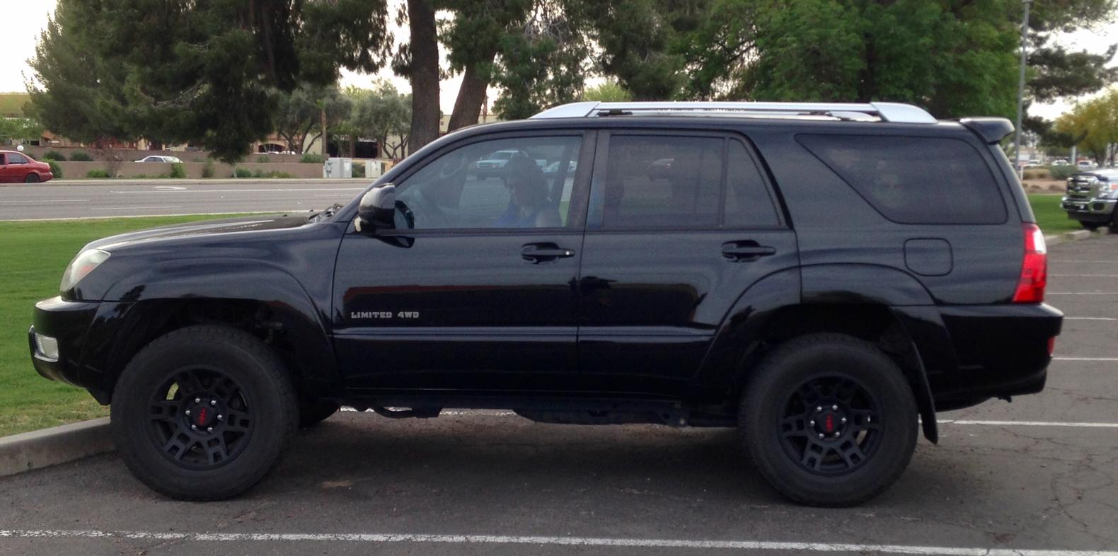

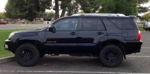

I am Running FJ Springs Front/Rear. 5100's Front Rear set at 1.75 and No Spacer in the Rear.

The 32 in tires on mine just look too stuffed.
Plus if I have any weight in the back it looks like the nose is higher than the rear. That's why I was thinking of going up a notch and lifting the rear a bit more.

Agreed. I am also going to either a 275-70 or a 255-75 Tire from the 265-70 I have Now.
