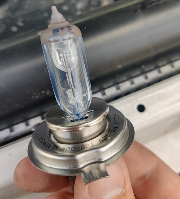

I recently put 80/100W Hella bulbs up front for better view at night, with the supporting wiring harness. I originally got the idea from the thread listed below, and everybody said it worked great for them. Only a month or two after install though, I noticed one bulb was very dim, but still lit up. Inspection of the bulb shows that the reflective material at the tip of the bulb has started peeling off (see photo). Both sides look like this, and I imagine it's only a short time before the other one goes out too.
Anybody else experienced this, or have any ideas why it could have happened? Seems like the bulbs are getting too hot, but I'm not sure why. I do have the rubber dust boots on my headlights. I ordered some new bulbs from a different supplier, will see if it was some knock off product form amazon.

I ran those bulbs for a couple of years without issue. If I recall they were pretty cheap, like a few bucks each. Probably just a manufacturing defect. Seems like you covered the other bases.
I installed mine over 3 years ago and they are still going strong.
i dont buy anything from Amazon that could be counterfit...i got burned too many times.

I am running those too and also bought from RockAuto. The bulbs are running good and no issues. I am using the stock wiring as well. The fading of the outside of the bulb should not cause any drop in output intensity. How is the reflector of your headlamp housing? Has it become dull?

I also think this may be the issue. With a perfectly clean new glass like I had when I installed these same bulbs it is a non-issue. If there's dust on the inside/outside of the glass or on the reflector itself, that energy (energy = heat) is not leaving the housing and instead is being reflected elsewhere in the headlight housing and potentially back onto the bulb itself. We are running almost double the wattage over stock so it's almost double the heat as well.
Is it tinted blue? I looked up a 80/100 on Summit Racing's site (legit retailer) and their photo shows a clear bulb
[MENTION=741224]JustAnother3GT4R[/MENTION] - the 80/100 are plenty bright for me, and the 130/90 bulbs would probably be overkill for my use. I'm thinking the same about Amazon.
[MENTION=85046]nissanh[/MENTION] & [MENTION=115347]gamefreakgc[/MENTION] - Like the other 20+ year old rigs out there, yes my housings are dull. The reflective part has started to oxidize but I cleaned them out with soap & water recently, so no contaminates. I don't really see the bulbs burning out from the housings being slightly hotter due to oxidation. But we'll see when I get the new bulbs. Thanks for the input.
[MENTION=75868]Ed_C[/MENTION] - The bulbs are clear, the blue tint is most likely reflection from the sky. Good eye though!
