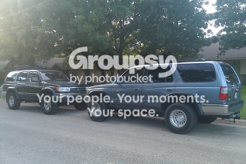

Cant speak on the sr5 flares but my limited flares are a tad bigger than the bushwacker flares on the blue one. I owned the blue one some years ago before we gave it to our nephew for college. The bushwacker flares were very easy to install and all the mounting holes lined right up. 45min task at best.

brothers1.jpg~original
sport and limited flares are same size I believe
Limited flares have body cladding on the doors-but the flare size itself is identical to a Sport flare. I believe that is 2" flare coverage.
Sr5 flares are the black plastic, and significantly less coverage sticking out from the body. I believe the figure is 3/4"
Bushwackers would be sized between the Sport/Limiteds and the SR5s
I have the Extend a Fender Bushwackers- I believe the figure is 1.5" but a check of their website would verify.Rivets and screws are used.
If you get the Bushwackers let 1fast e install em for you! The back door pieces alone are a bit tricky. There is a mounting plate that fastens to the door, then the door piece of the flare mounts to the plate. I had mine professionally done and it was quite a bit more than his time stated. But obviously it turned out great.
Good visual comparison and thanks for sharing the picture in post 4
