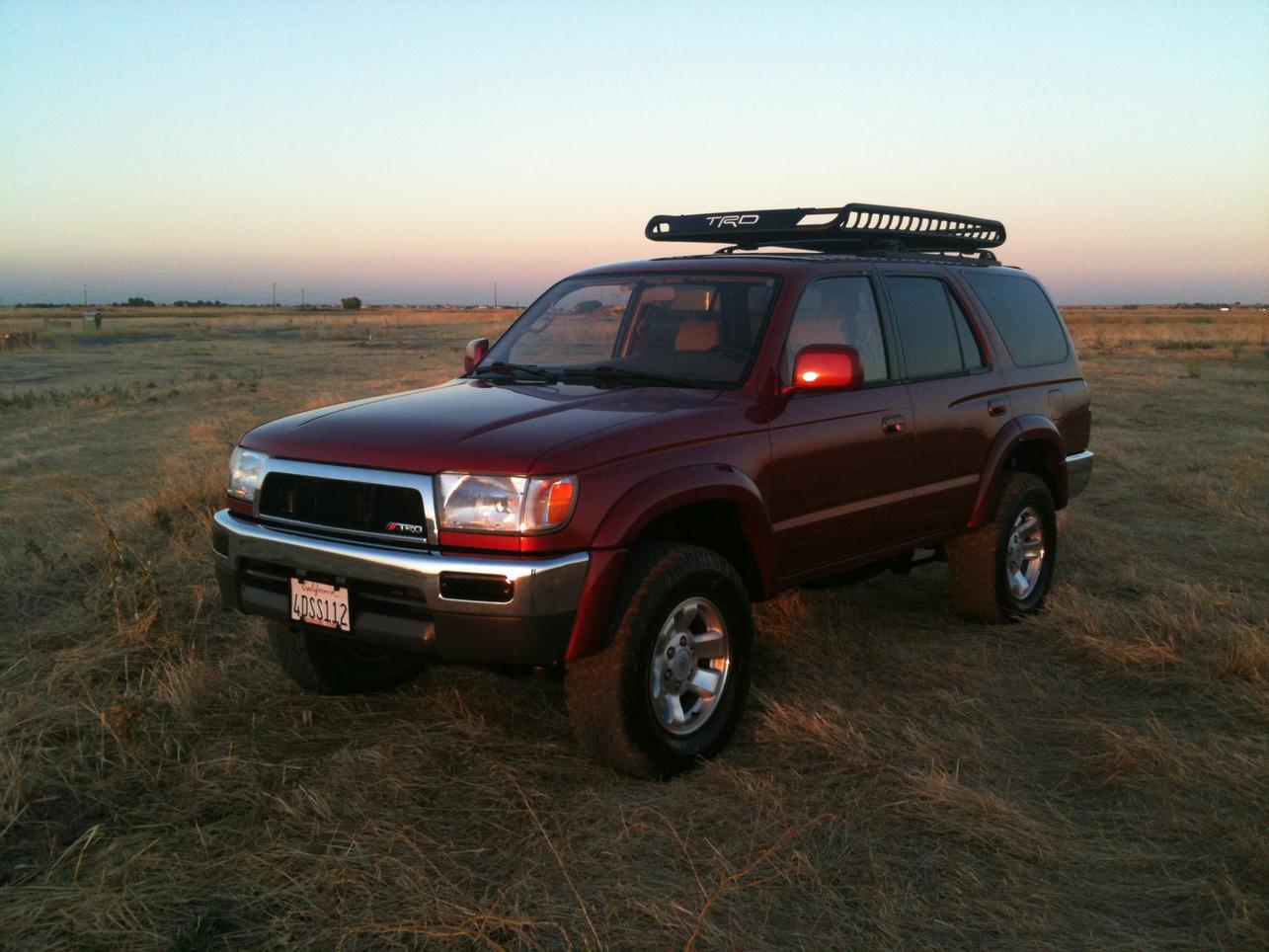

Had them on my 98 and they were a breeze to attach and toyota already had the holes pre-drilled to make installation a cinch.
I just couldnt attach the front bumper parts because of rubbing.
The are extend a flares are smaller than the limited flares. I would say just the right size for me anyways.

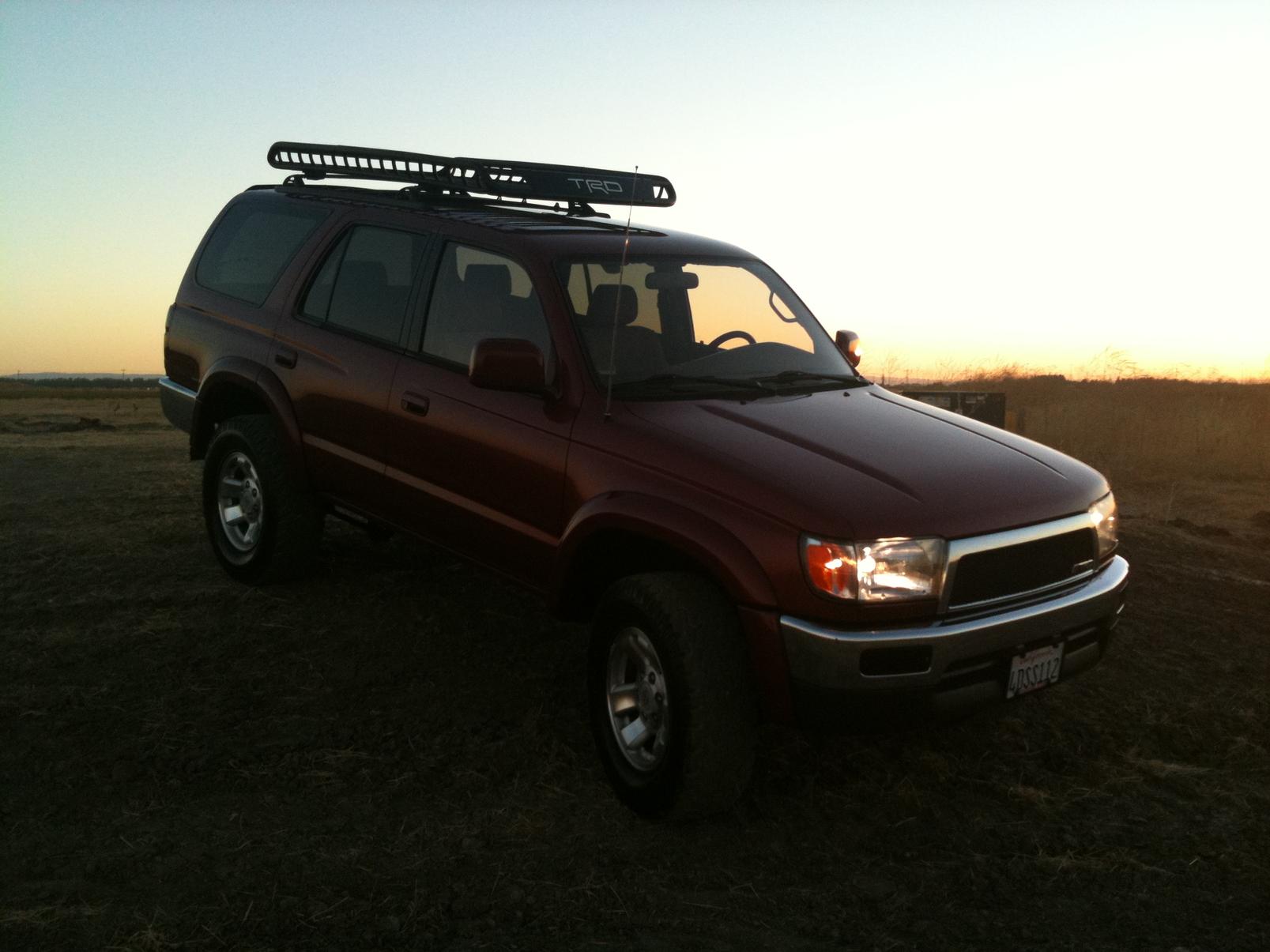

Those are the extend a fenders in my photo and more on my Facebook link. I also do not run the bumper extension pieces. I believe the coverage is 1.5" and yes it is pretty good coverage.

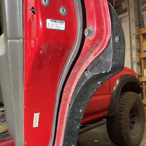

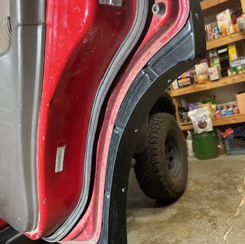

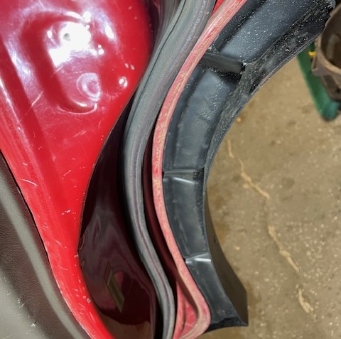

The Bushwacker installation instructions are not great to say the least. Can anyone provide me with, or direct me to some photos and further details on the rear flare install, specifically the portion that mounts to the rear door.
Thanks

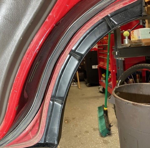

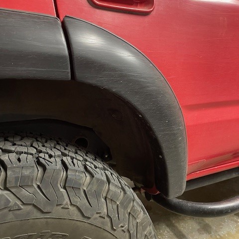

Welcome to the site. I did this recently and remember the rear door mounts being a little hard to figure out. The inner section mounts directly to the door with tek screws and the outer section mounts to the inner section with rivets. Hope these pictures help out.

The number one reason I got them was attempt to stop my tires from trowing mud all over the side of my truck. My tires don't stick out much but it was pretty bad in the winter. I find it's made a worthwhile difference. They look decent but that wasn't a priority. I've scratched the hell out of them with branches on narrow trails and they're still mounted solid. The fronts attach using screws in seven or eight existing mounting holes and the rears use tek screws to mount to the bottom of the fender. The doors are the trickiest part like I described above.
