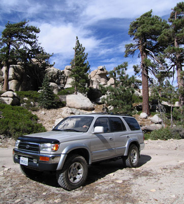

Alright, picked up a 1998 w/the rear locker... and she's in BEAUTIFUL condition.
Took her up to Big Bear the same week (Oct 13th) and put that locker to good use.
Now, it's on to the mods ;):
