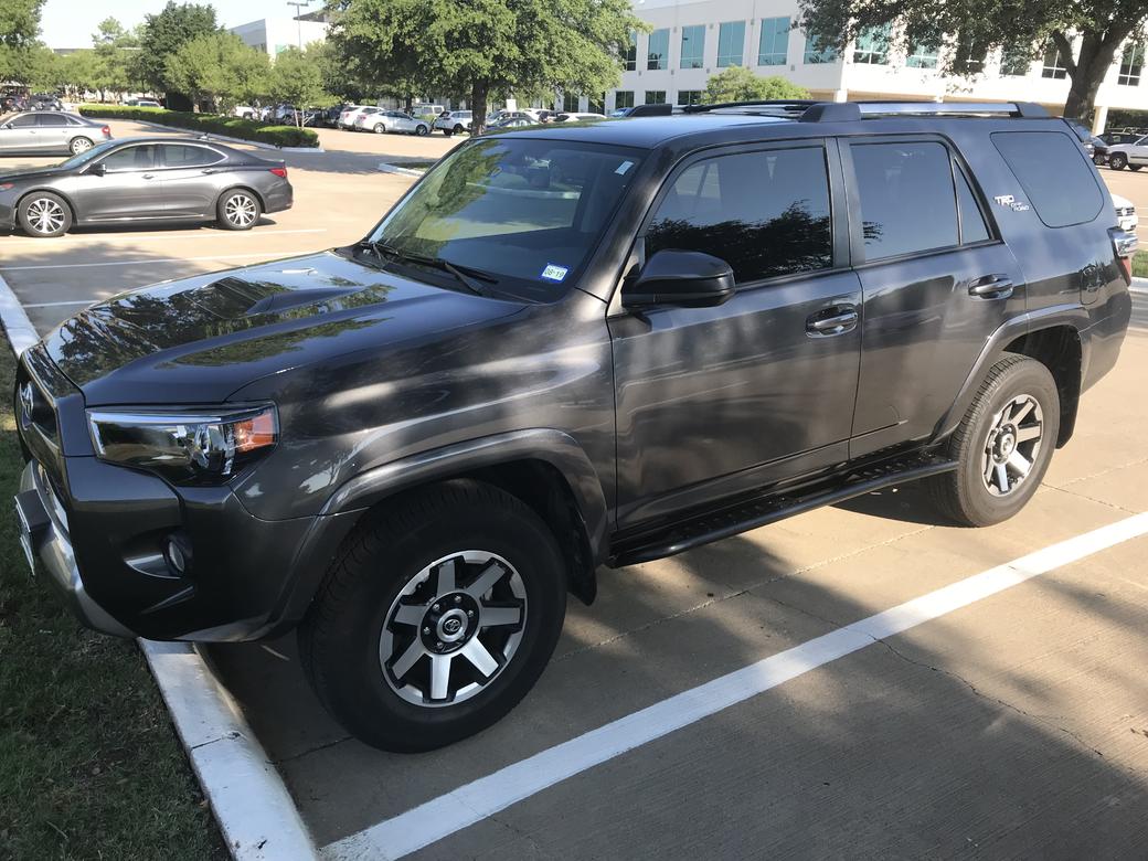

Got them on this past weekend... super happy with the workmanship by C4 Fabrication and Tuff Powder Coating in Dallas!
From an install standpoint, I highly recommend taking the optional step in the instructions of temporarily removing the 4th bolt from the rear driver’s side end of the factory gas tank skid plate to get the skid to hang down low enough... not sure if I would’ve been able to get the driver’s side slider on without it... I fought with it for a little bit before giving up and removing that bolt and then it went on easily. I saw an install video as well where they completely removed the skid and called that a good idea to do, but that feels like overkill because one of the skid plate’s bolts is pretty hard to get a wrench to without a flexible socket wrench.
