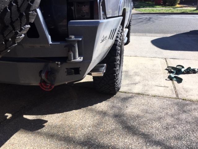

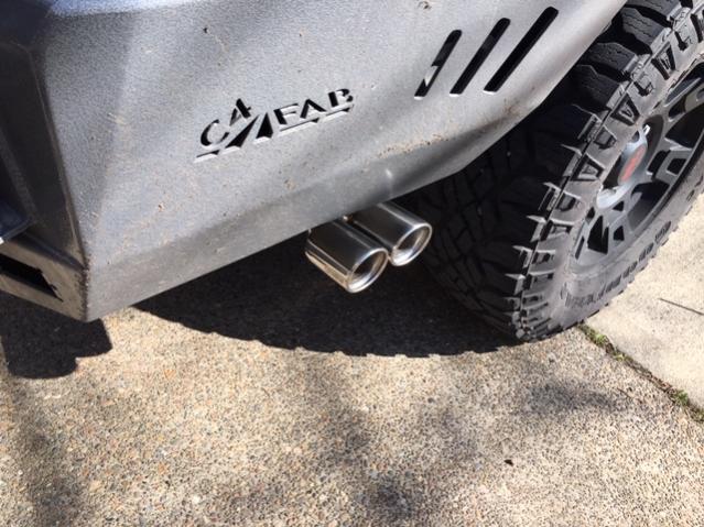

I cut my exhaust off when I installed my bumper and finally got around to welding in a side exit and dual stainless tip I got on Amazon, looks pretty good
Are you concerned you'll smash the exhaust coming off a rock? I have mine cut off also and just put an angle on it so it ends up just inside the bumper and slightly below
your exhaust tip placement is exactly where i hit, scratched up, and dented my oem bumper during offroading. that is the reason why i decided to buy this C4 rear bumper.
Yea I wondered about that but we will see. its not like I have much of any money into that, tip cost $20
The C4 bumper adds a lot of clearance compared to the OEM bumper so time will tell if it gets crushed or bent, Im sure it will at some point but who cares, I'll cut it off again
