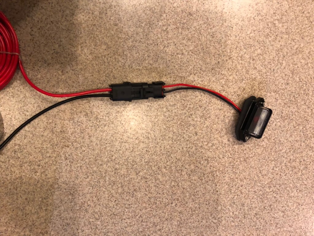

5. License plate light... stay tuned, haven't done it but I think I have a plan. I ordered some weatherproof automotive plug from amazon so I should have a good way to remove the fixture in the event I need to get to my spare.

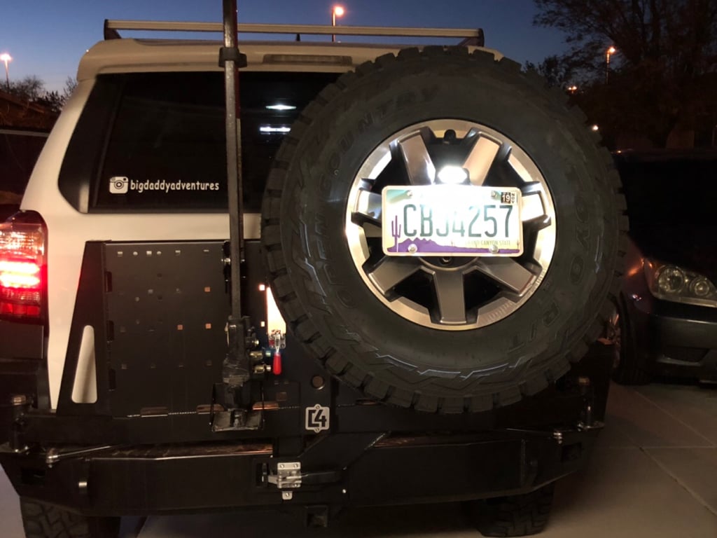

Another piece of the puzzle. I ordered some “weatherproof” plugs from amazon so the plate can be removed to get to the spare.
Well, I’m not nearly as smart as I thought... turns out the plugs don’t fit through the hole in the bracket. We’ll just call that one a practice crimp. Anyways, after un-“F”ing that got everything routed and spliced into the trailer plug. Now I need to pull the bulbs from the factory license plate light because that looks weird glowing in there. lol
