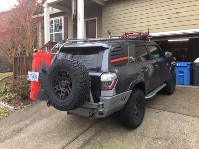

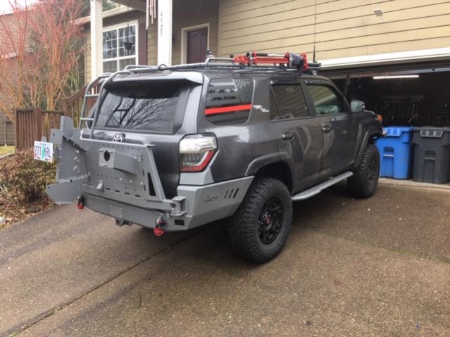

As far as powder coat it would have cost me money to sandblast it if they had automatically powder coated it. I didn't want black like every other aftermarket bumper. I went with a hammered grey

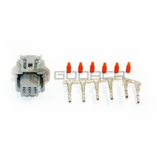

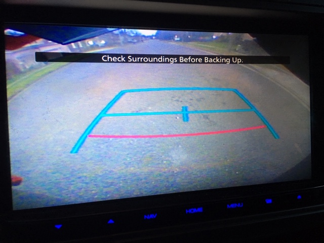

Also to do the camera relocation just go buy this factory connector on ebay or amazon that plugs into the camera and run your own wire. back to the factory connector in the hatch and your done.
Connector 6 Pin 6-way sumitomo automotive for Toyota w/out wire
1x Connector 6 Pin 6-way sumitomo automotive for Toyota w/out wire | eBay
Ive since changed some things like the wheels since the first pics were taken

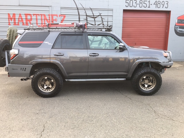

The camera relocation took longer than the bumper install to do it right and sleeve your cabling etc
