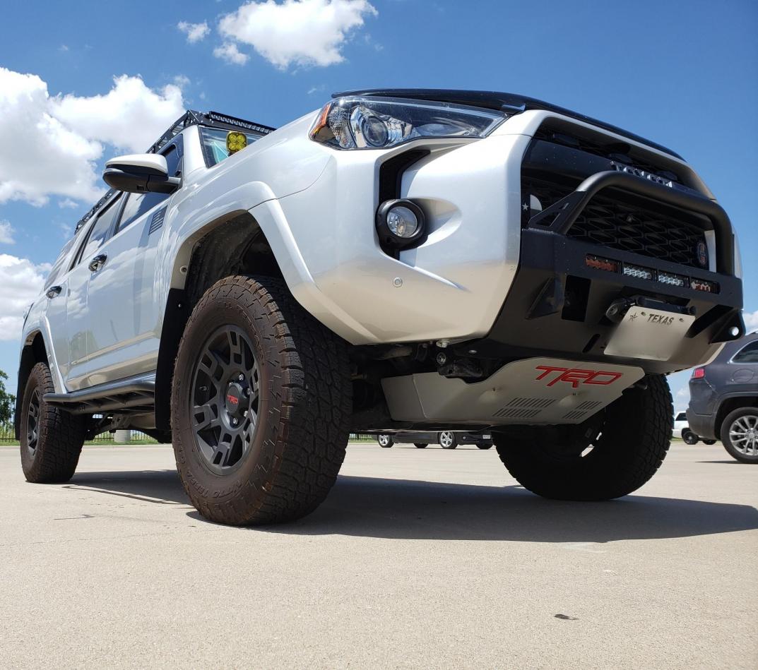

c4 lo pro w/ TRD skid
Do you have this setup on your Rig? would like to see a picture if you are bored enough to post one. Thanks!
Like this?
