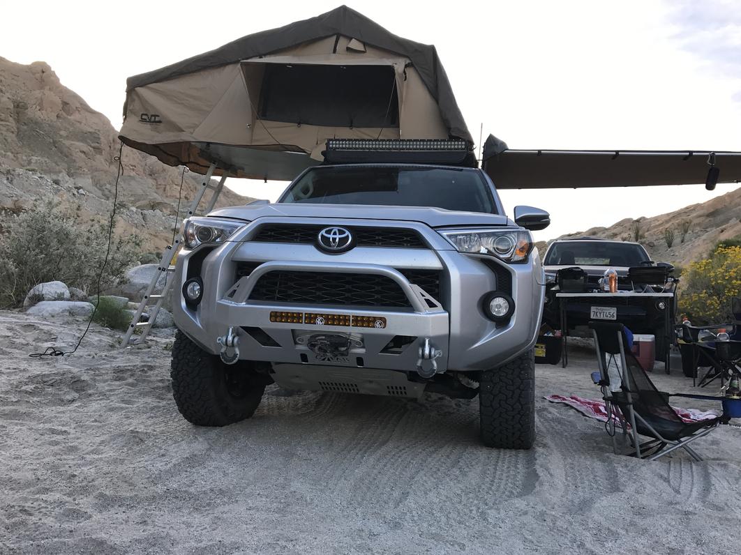

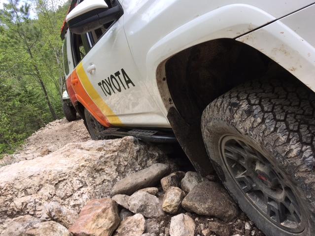

I had Caleb from C4 use his guy and so far so good, no chips or issues with bumper. I have ran thru quite a bit with it. You can see small scratches and such but no chips or anything gone to metal.
....my sliders however within 30 minutes of install were all f'd up! ;)

Rattle Can
Congrats! I used rattle can for my C4 sliders, skid, and front bumper. These inevitably get scratched and it is easier to touch up.
I used duplicolor perfect match on the front bumper and am really happy with how it turned out. It's all prep work and there are some tough to reach spots under the winch plate. Take your time and it will turn out great.
