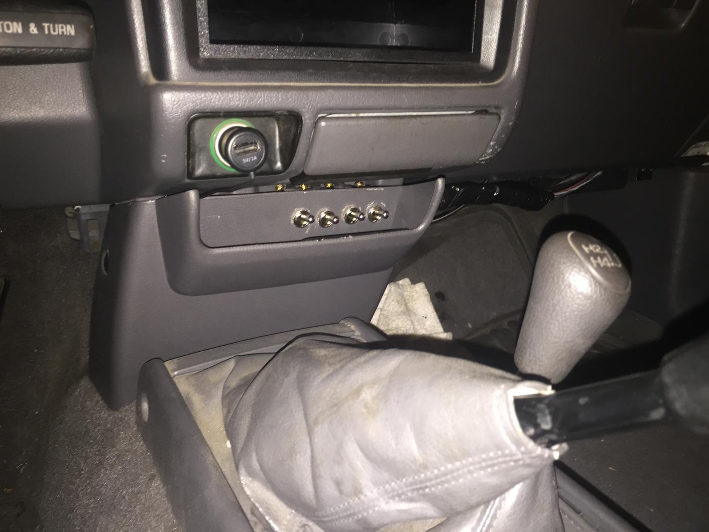

Toggle switches
I installed mine and ran the sensor wires thru toggle switches so I can deactivate the entire URD system and bypass it altogether on demand. (With engine OFF of course!) This also comes in handy in case something happens and the URD system were to malfunction. It allows for the system to operate normally as it would with just the S/C. Pretty slick I thought. But I have friends in high places lets just say and they will indeed assume the additional injector is part of the 50 state legal TRD set up.
Here's a pic of the toggles. One per sensor (crank, cam, 02, as well as for the URD's ground to completely shut it off as an ultimate failsafe)
