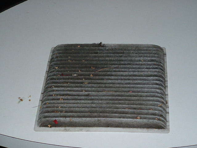

I changed my cabin air filter out last week and here's what it looked like after 13k miles of use. I purchased mine from Lou Fusz Toyota in St. Louis for $18.00. It was an easy swap.
Ciao,
Jon
Cap
Wow!! $18.00 I paid $13.00 for mine at the local stealer.
I looked at mine after only 1 week. It was already quite dirty and black.....Gotta love that clean SoCal air. :mad:
From the looks of that picture I should buy one and put it in. I just replaced my girlfriends in her civic at 13k and there were bird feathers and all sorts of weird stuff in there. Of course when I asked her about it she said that she never hit a bird....yeah right.
