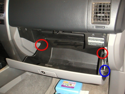

BTW my vehicle is preowned, today morning I removed the glovebox to pull the air filter and found that the pushrod which the manual says must be unscrewed from the glove box was freely hanging to the screw(i mean it was not attached at the other end and felt that there was something wrong with it)
any suggestions on this observation

please see attached pic with the blue circle I am talking about that arm not connected on the other end

The rod should have 2 holes in it, the one towards the middle of the rod should be hooked onto the dash panel to the right of the glovebox. Just unscrew the rod from the glovebox, pull the glovebox down (to disconnect the latch where you circled the red areas) and you'll see a small protrusion where the hole on the rod should go.
It's not a big deal, mine is pretty flimsy and comes undone everytime I take off the glovebox.
As for air filters, my dealer sells them for about $18 and oftentimes you can find them on eBay for about $13. Many people have made their own using the filters for home air conditioners.
actually unscrew (BLUE CIRCLE) it first, theres only one push rod, then the two tabs holding the glove box, push them inwards, that should drop your glove box down to access your ac cabin filter.

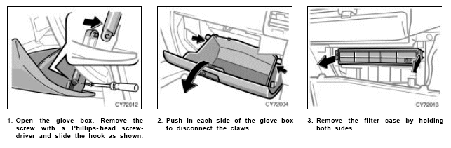

It's been said above already, but here's the diagram from the 2006 Owners Manual.

BTW what is the function of that arm on the right side of the glove box (circled in blue)
well i guess after fixing the rod i felt the glovebox now opens smoothly rather than opening with a jerk.
It's a damper so the door opens smoothly and slowly, rather than just dropping open.
I changed the air filter without removing any screws. I did have to attach the dampner back, but, it was easy.
