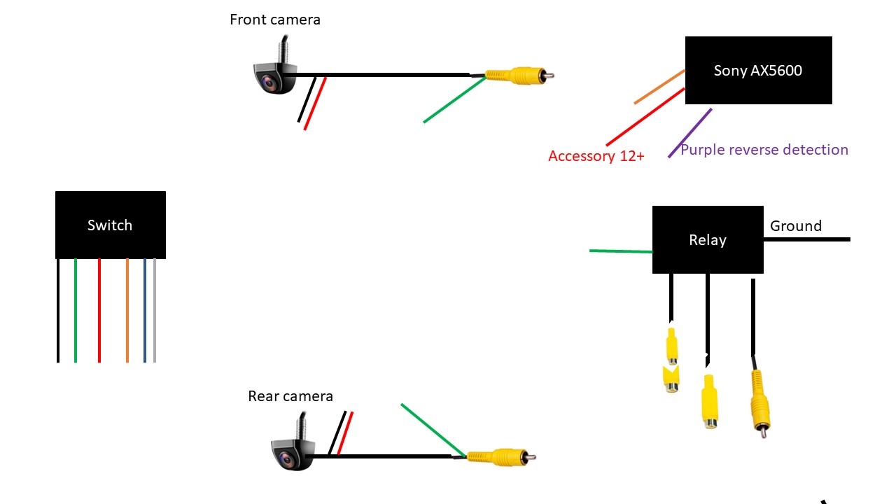

Looking for some guidance on wiring a front and rear camera for a 2011 SR5. The cameras are all routed to the head unit, and now for the fun part...
The stock head unit has a CD player and did not have a factory back up camera installed. I've watched a lot of the videos on the install, but they all use the harness that assumes you already had a stock backup camera.
Any advice on which wire connects where?
(I did reach out to TGP and anytime backup camera, but they seem to be swamped--glad to know business is good! any help is much appreciated.)
Thanks!
Here is the current situation--colors of the wires are the actual colors. Thanks!

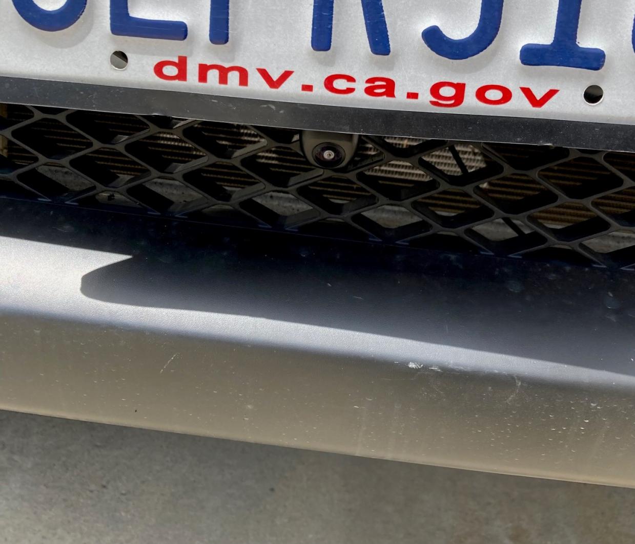

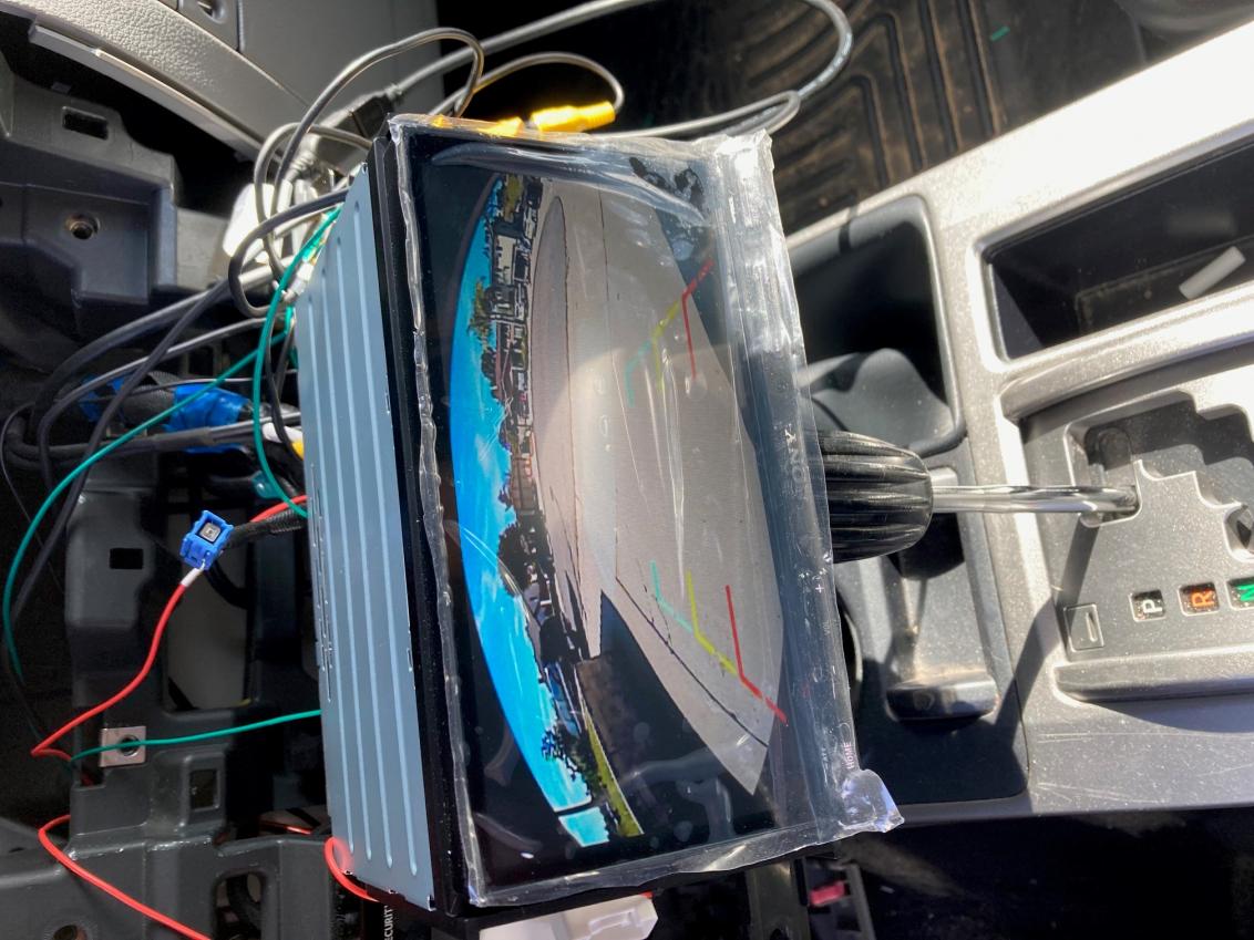

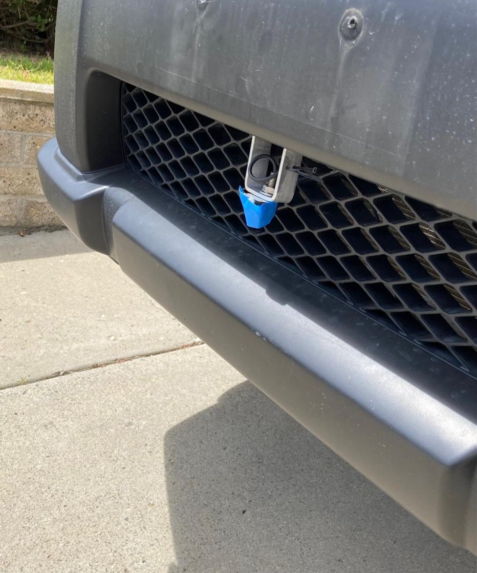

Brian at Anytime Backup Camera got in touch with me regarding my questions, and he has been great--excellent information, and very helpful for a novice like I am.
Front camera is hooked up and working, and we're trouble shooting the rear camera (possible faulty camera, but will see.) Made a small bracket for the front so the camera peeks out from under the front license plate--looks almost hidden.
