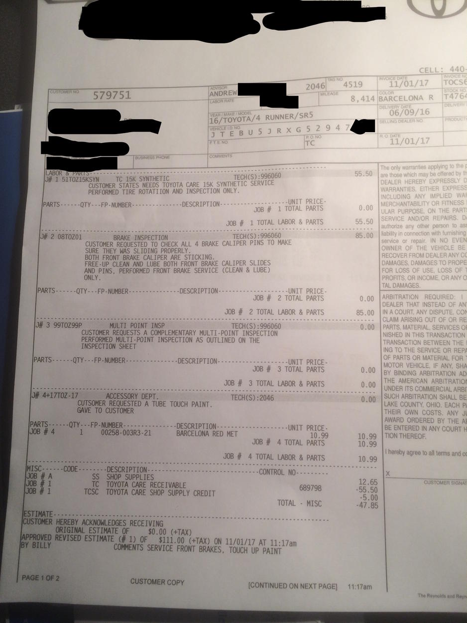

Caliper service at 8k miles, $90
BlackWorks, I had issues with my pins, that nobody noticed, which caused me to replace the pads and rotors. Made sense to have my dad ask for his to be checked to prevent the same thing from happening to him.
What do you mean that the caliper pins were having issues? How did your dad even know they were having "issues"? Did he try messing with them? There's a lot of unanswered questions here for a vehicle with only 1yr/8k on it.
That being said, without knowing entirely what's the issue here... it's hard to say what the issue and/or "fix" was.
But, IF the issue was due to one or two wonky caliper pins (I've seen a few so it's very possible) then it should have been covered under 3yr/36k bumper to bumper warranty.
As for them being "serviced" well you're not really supposed to grease them, but taking a brass brush and knocking off any rust and/or crustiness they get on them and maybe using a pocket screwdriver to clean out the bore (or a small bore snake) if they're really crusty isn't a bad idea if you're doing brakes. Sometimes they can get bad enough that trying to pull them out doesn't work well; but in my area that's very rare to see in vehicles that haven't been around at least a decade and/or a hundred or more thousand miles. Maybe it's a bit more prevalent in rust belt areas?

Update: I emailed the manager (service manager was of no assistance) and he has agreed to refund what they charged my dad for the brake service. I shared this link, and I'm sure I can thank you all for posting your feelings on the matter. :party: Thank you!
That's good to hear, and I'm glad you contacted them instead of just writing the place off automatically.
Lot's of people seem to do that with dealership service departments, ours gets 3-400 cars daily. It'd be a little hard for all our service writers to know every single person and their history the moment they drive in.
