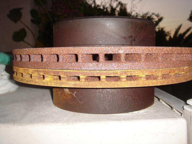

I just pulled rotors from a donor hub I'm planning on using for a friends T4R. The Rotor I pulled off was pretty thin compared to the stock rotor I recently replaced. When I get home later, I'll post a picture of the two rotors, with measurements.

FWIW, Here is the picture of two rotors from two different 4x4. The lower one is one I pulled from a donor hub, I blieve it was from a 94, on the inside it has a Min Thickness of 18.00MM. The upper one is one I pulled from my own 93, when I changed the rotors, Min Thickness 20.00.
