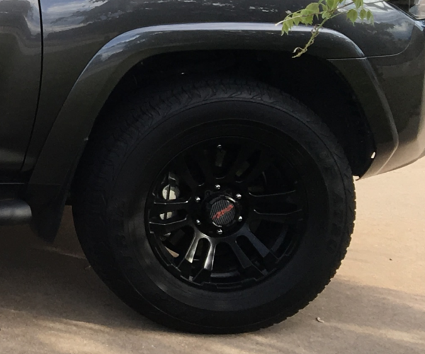

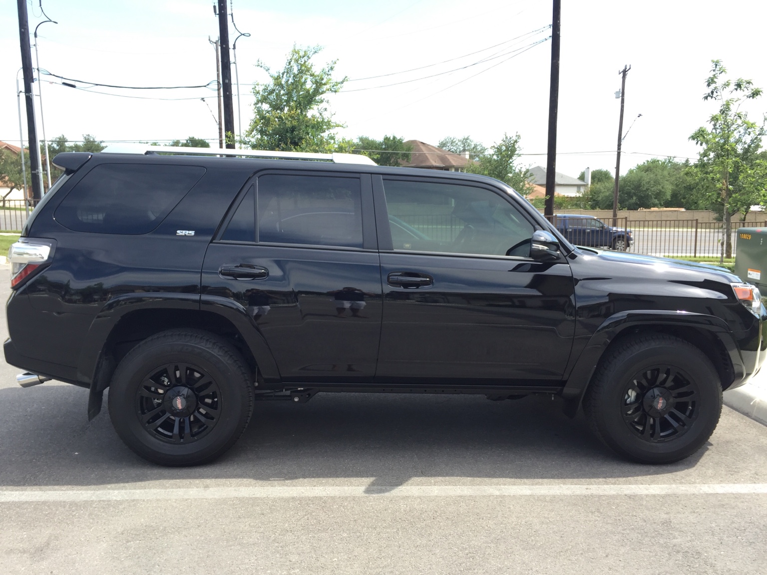

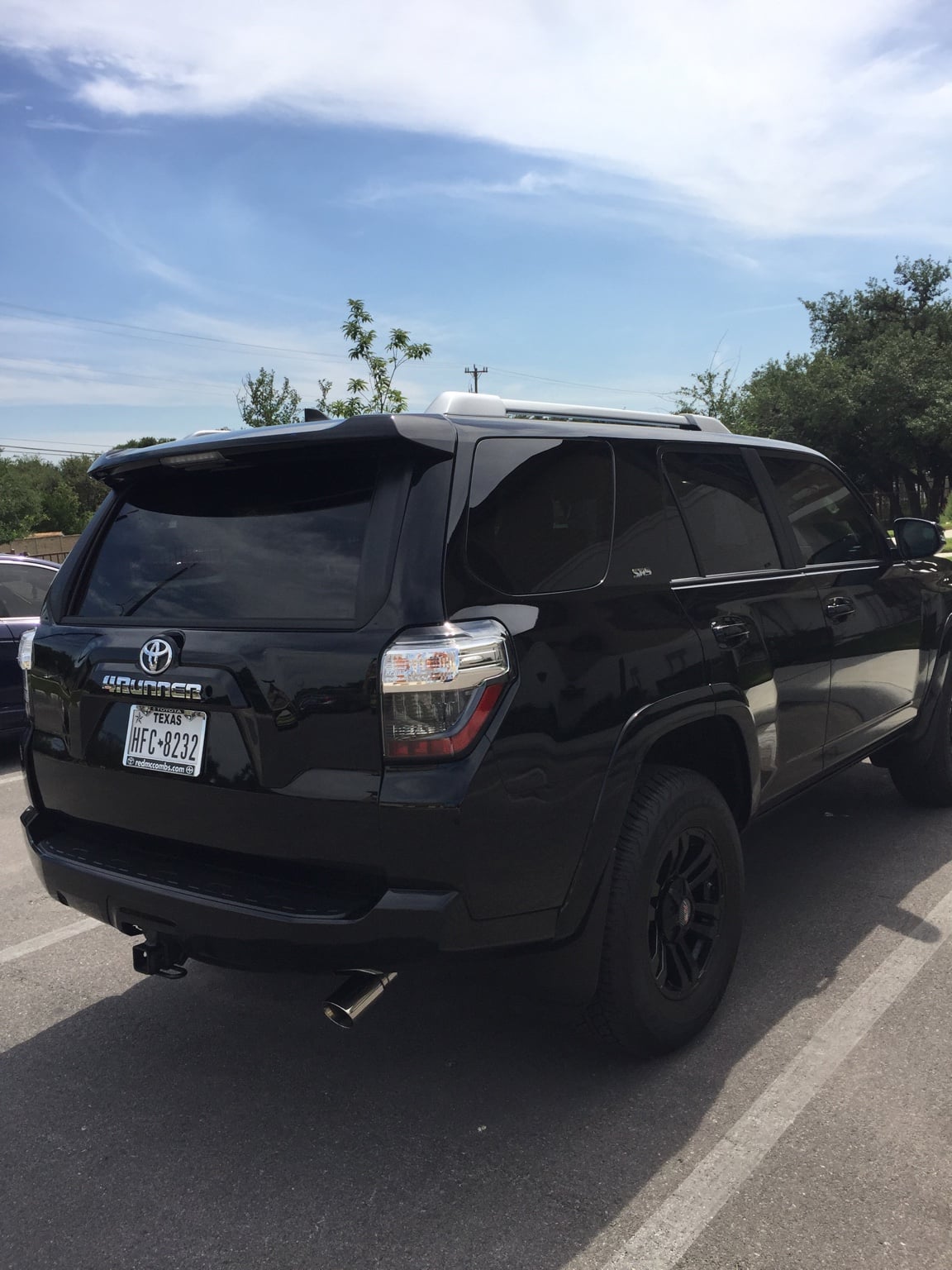

I'm riding on Level 8 Strike 6 wheels with Nitto terra G2's 265/70/17 , it has a little poke but its fine with me.
it rubs while i reverse on full lock...
17 X 9
Offset -12
BS 4.5

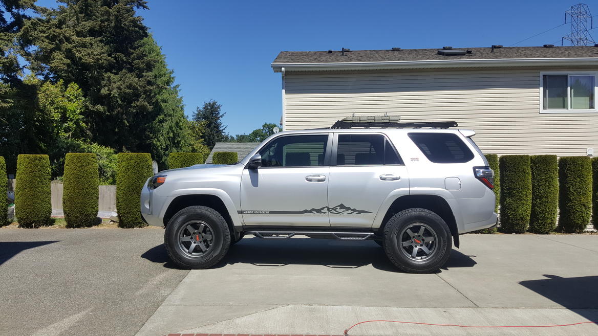

I have the 0 offset. I do not recommend these wheels if you plan on traveling gravel roads. The spokes are set out far enough that my rear wheels are completely pitted from 1 (one) 56 mile dirt trail. I just had the TPMS rebuilt and move over from the TRD Pro wheels.

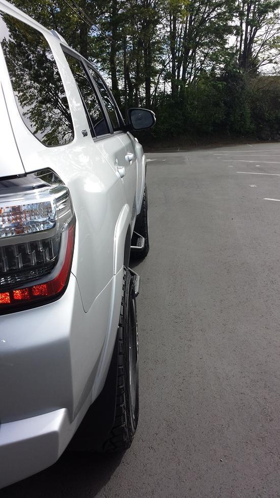

-12, cant say im not cheating with 1.25 spacers as well though. Reccomend both for the aggresive stance. Rubbing is a pain though, and is a reality with any kind of wider stance (rim offset included)

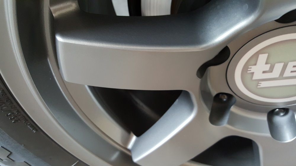

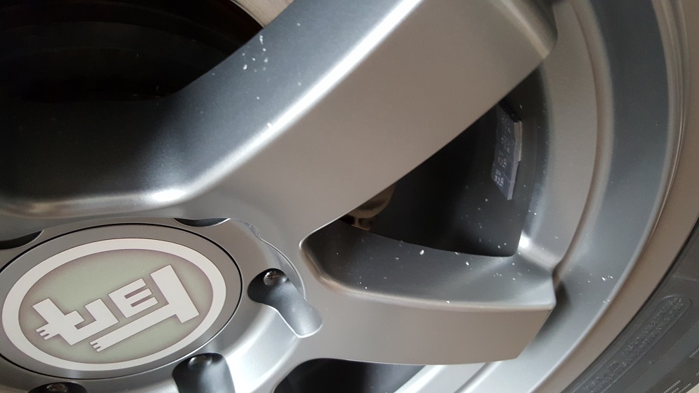

Here are the pics. The damage is on the forward rotating side of the spokes. As you can see the rear side didn't get pelted with gravel.

Anyone else out there all pitted up like Tiggers? I am about to purchase the the matte black ones, but this has me a bit concerned. Obviously the black could look even worse than the grey if this pitting happens. Bah! Why did I have to see this..... :mad:
If you get a deeper offset and don't run gravel roads at 50mph with 18PSI you should be fine.
