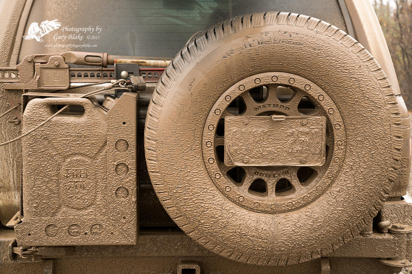

I have the Scepter military grade one, fits fine, very snug. A very well made product, highly recommend it. Just be aware that at least here in Canada the nozzle is not included and needs to be purchased separately

I have the same Scepter military can above on my Shrockworks rear bumper.
It fits well.

I have mine reversed to what he has in the picture, with the cap facing inwards on the tire side. Just went out to double check, the way the cap is angled on mine the top edge of the cap is about 1/2" higher than the handles so it needs to facing this way to fit under the angled part of the Shrockworks bracket.
The red one in that picture is not the same as mine though, different cap and emblem in the center, not sure if it is a metal can or they have changed the design? Mine is a couple of years old but these were designed for the US military so the design should not have changed.
