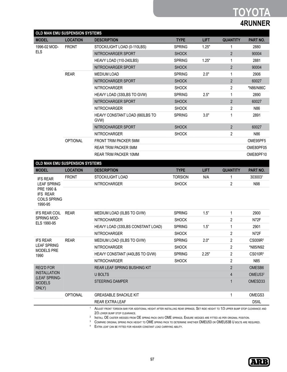

I spoke with an Arb tech, they told me that the 60027 shock has never been recommended with the 906 coil.
That is not true.
Here is ARB's application guide for the 3rd gen which was released at SEMA(November). The 60027 shocks are directly below the 906 coil and there is no mention that one cannot be used with the other.

Dont kill the messenger, I am just relaying what the ARB tech told me.

I just spoke with ARB, and they are going to send me a pair of 60028's. Thanks Aschweg! As for the 906/60027 combo, Dylan is right. When I talked to ARB, the tech told me it was an ARB error, not Toytec. While it would have been much easier if Toytec would have replaced the shocks, I understand why they didn't. It wasn't a distribution issue. It was a product issue, and ARB is stepping up to the plate to make things right. When all is said and done, I feel that both Toytec and ARB provided outstanding customer service. I would do business with both again.
A word of warning to those purchasing 906 coils: DO NOT MATCH THEM UP WITH THE 60027's.

Actually, I thought the same thing at first, but then I removed the bottom mounts of my OME shocks in my driveway, and found that the coils are quite capable of traveling up and down with my jumping on the bumper. With the shocks fully installed, it doesn't move much at all. Therefore, I determined that the cause for the extreme firmness was shock, not coil. I do agree that the coil is stiffer than the OEM coils, but they aren't stiff enough to bounce the rear end of a 4runner across a paved road. Those with 906's, don't be fooled. It's shock, not coil.
