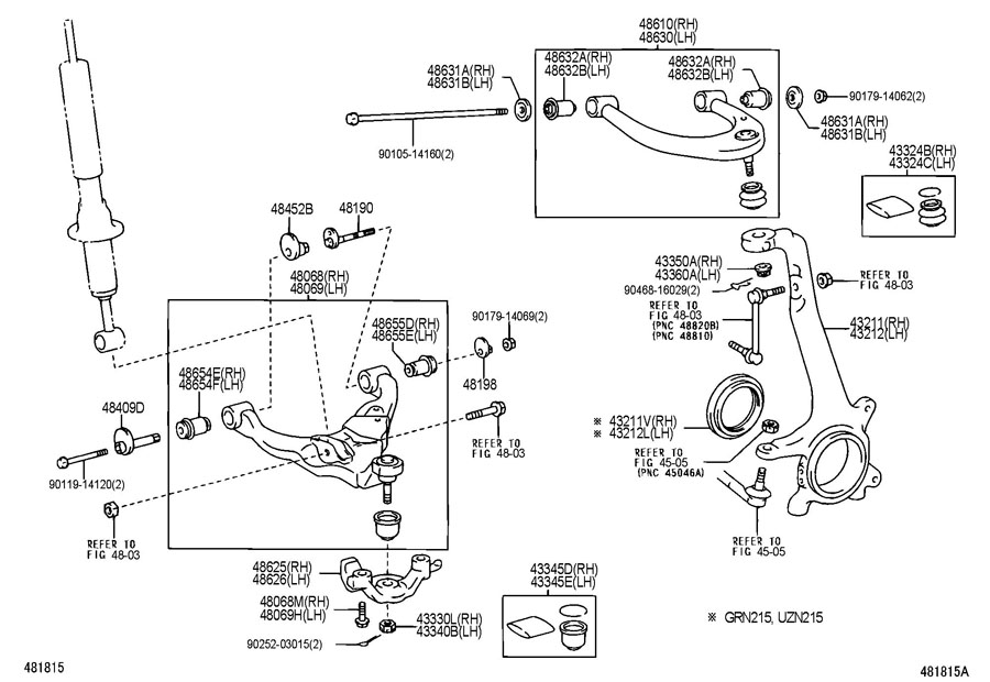

This is wrong.
Front and rear camber bolts are different.
Front bolts are 3 pieces/parts and rear bolts are 3 pieces/parts.
This is what I bought to replace my two lower control arms on my 2007 4RUNNER. I attached a picture below to make sure you get what you need.
x1 - 4806860010 ARM SUB-ASSEMBLY, FRONT SUSPENSION, LOWER No.1 RIGHT $321.67
x1 - 4806960010 ARM SUB-ASSEMBLY, FRONT SUSPENSION, LOWER No.1 LEFT $321.67
x2 - 4819060020 CAM ASSEMBLY, CAMBER ADJUST; CAM, FRONT SUSPENSION CAMBER ADJUST, No.1 LEFT; CAM, FRONT SUSPENSION CAMBER ADJUST, No.1 RIGHT $21.08
x2 - 4819860011 CAM, CAMBER ADJUST, No.2; CAM, FRONT SUSPENSION CAMBER ADJUST, No.2 LEFT; CAM, FRONT SUSPENSION CAMBER ADJUST, No.2 RIGHT $20.34
x2 - 4840960020 CAM SUB-ASSEMBLY, FRONT SUSPENSION TOE ADJUST $26.78
x2 - 4845235020 PLATE, FRONT SUSPENSION TOE ADJUST, No.2 $28.52

Thank man this is what I'm looking for
Here is a view with one put together and one took apart beside it.

So just wanted to post a update on the post... these are all the parts to need to replace the low cams on both sides front and back
48190-60020 adjust cam x2
48198-60011 adjust cam x2
48409-60020 lower control arm plate x2
48452-35020 lower control arm bolt x2
90119-14069 control arm nut x2
